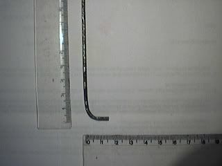

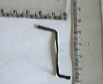

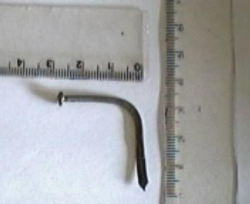

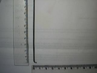

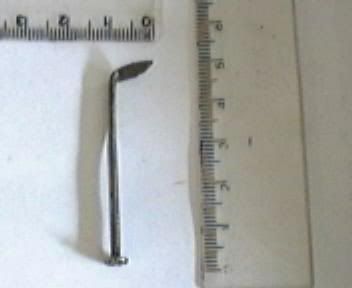

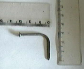

Postby Wrenchman » 19 Mar 2006 22:01
May I suggest that you make the wrench yourself, that way you´ll get what you want, and it is easy, all you need is a nail(see pic. 1, 2, 3, and 6), a hammer and a couple of pliers and then a block of metal for the hammering.
Image Image
Image Image
