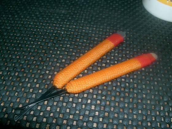

As a lockie when I go to a lockout I always use my pickgun so a few days ago I got back into pin picking because this is a skill I don’t want to lose, and after a day of picking my index finger was throbbing because of the Majestic picks which have quite sharp handles.
So I decided to do something about this

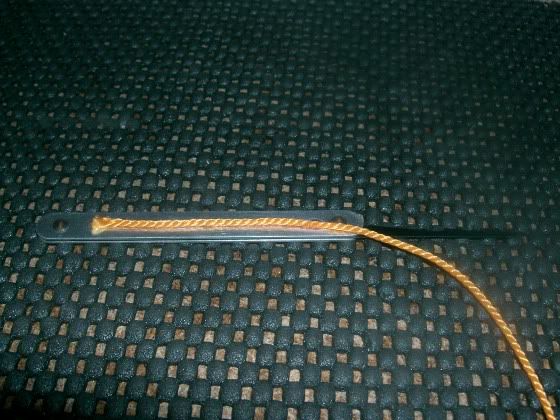

pic 1.first I super glued the string along the pick.

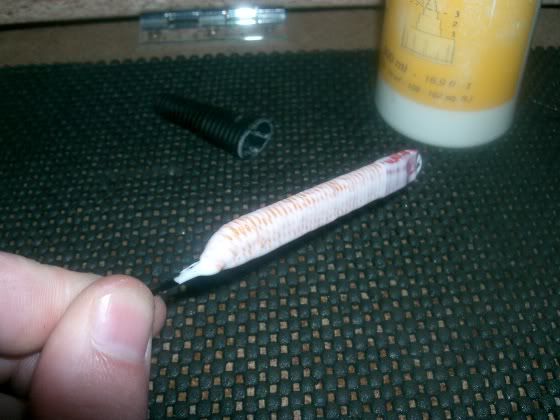

pic 2.then I started to wrap the string from the pick end to the other end.

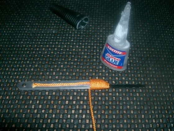

pic 3.when I finished the wrap I cut it off and glued it and taped the end.

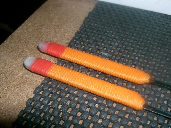

pic 4.a coat of PVA wood glue which holds it all together and will dry clear.
pic 5.finish off by dipping the end in epoxy resin.
they feel a lot better and when there in my toolbox I can now see them
