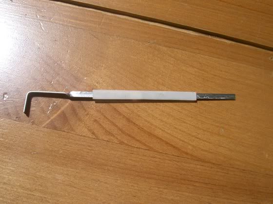

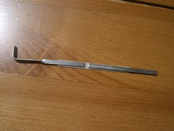

i made some tension wrenches from wiper inserts but they are quite strong(not much flex)so i made these super flex ones.
not sure if it's been done before but here go's
i took an old peace of mica and cut of the bad stuff then cut a strip of it for the spring
the cut a tension wrench in half and sand each side for the superglue the stick
then glue it on both sides and leave a gap in the middle about 3-4mm
then you have a very light tension wrench.

Very creative i give it a thumbs up buddy, i think that its plauable to work (ugg i sound like the myth busters) anyway how flexable is the material meaning its it flexable enough to transfer you down ward motion to the part in the lock, i say this becuase i copied the feathertouch wrench with standard tension wrench material, by making the circle, and then ground down the circular part so that it would be less firm i found that to get it right is tough my first on i litterly broke because i had to bend the little bugger so much just to get light tension to fell.
I like it though great idea :D

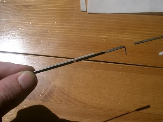

Postby illusion » 20 May 2006 7:12
Hey mate, that's a great idea. :D
I made a feather wrench before, but did it another way:
I'll have to try your idea with some Mica later. :P
Thank you for sharing. :)
