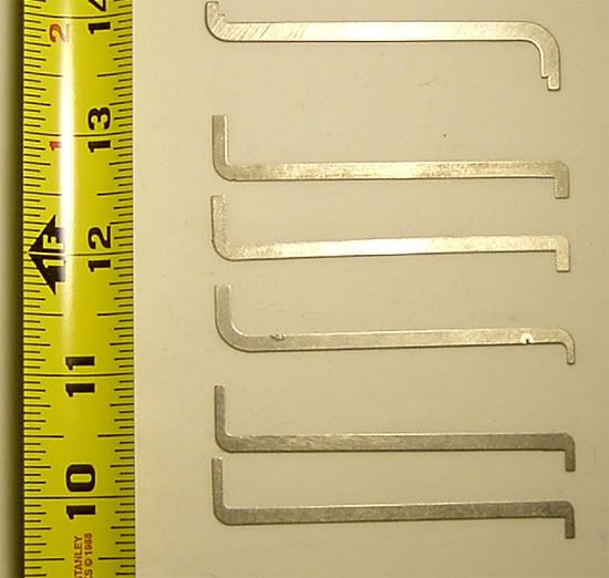

Just got these today, VERY cool wrenches, very useful. You will especially like these if you like to hold the lock in your hand while you pick it (DB :wink:). The top one is the Peterson Pry Bar, sold separtely, and is definately worth getting (or making) as it's a lot thicker than the other ones and is quite useful for stiff locks requiring a good bit more tension than usual. The flat 5 wrenches are two different thicknesses, a very nice touch, allowing you to vary tension from very very light to very heavy and even heavier if you've got the pry bar. The serrations DO help and are a nice touch.

look nice. how thick are they though?

I've had those posted in my head for a while on the to-buy list for the next time I order some lock tools. They would be useful for picking locks in certain orientations that somewhat prohibit the standard torque wrench from working.

Those are nice :P :P .
When you say serrated, you mean the edges are serrated? Does this get a better grip on the plug?

You can just make out small teeth on the 2nd and 3rd wrenches but i think i can also see them on the others,
The teeth are supposed to grip a lot better but mainly for steel plugs as they will easily mark a brass plug i remember reading on here a long time ago,
Can you confirm the damage thing DD?

I have used those wrenches for well over a year now. Easily my favorites and I highly recommend them. Quality tools despite the price (well worth the money). The pry bar is too thick for many many euro locks though. Just a heads up for anyone outside the US. It also will not fit the smaller keyways of many padlocks such as those on master no. 3's etc.
Postby Shrub » 21 Jul 2006 20:50
Do the teeth mark the keyway Zeke?

I made my own a long time ago, check em out.

close, but not near the peterons. The petersons are made of a stainless steel that I have nat yet identified. It is stonger than I have found yet. It is also serrated in 4 of 5 tools. It makes them nicer than anything that I have been able to make no matter how much time I have spent to reproduce them. Just buy them if you want the real thing. Trust me....

You can see a much better picture of the serrations here (scroll down):
http://www.peterson-international.com/tensiontools.htm
The serrations are smaller than you think, they're actually rather hard to even see if you're holding one in your hand. I'm sure they make some kind of mark on the plug you could find if you were really looking for it with a microscope or something but I REALLY don't think it's bad enough at all to worry about. So no, I really don't think the serrations cause any problems, however they do do what they're supposed to which is help to keep the wrench from slipping out of the keyway, which I like. So yeah, I'd rather have them than not.

Postby devildog » 21 Jul 2006 23:03
Ok, the pry-bar one, the thickest, is 0.047 inches
The rest are one of two thicknesses, 0.0234 or 0.0156 inches ( plus or minus a few thousandth's of an inch).

Well, the ones I made never come out of the keyway. I used the ones in the picture to pick the BEST H24.

Perhaps you could fake the serrations by running them over really coarse sandpaper. Or at least achieve the same effect.

Postby ThE_MasteR » 22 Jul 2006 0:29
I have a very slim file, i'll give it a try tomorrow.
