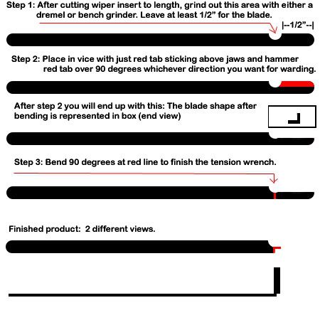

I posted these instructions in another thread, but thought this should get its own thread so people can find it. The instructions are for tension wrenches with blades that are bent to fit warding and prevent binding of the tension wrench on the cylinder walls. These will work on a vast majority, but not all keyways and a few of these will have to be made for different warding patterns. I will try to post pictures of the actual finished tensors in the next couple of days.
OK, here are instructions for making these tensors:

Postby pinsetter » 30 Aug 2006 11:04
For all my tensors I use only inserts from Anco 30-16, or 30-20 Wiper blades.
The Anco blades have the best inserts I've found to date.
For the first bend I do use a square jawed vice and a good heavy ball peen hammer. I hammer slowly so the metal does not crack at the sharp bend.
*When hammering the lengthwise bend in the metal I sometimes have to re-insert the piece in the vice several times!*
I mentioned this in another thread also but I'll do so again here:
These tensors will also teach you NOT to apply excessive tension when picking. There is an inherent weak spot created by grinding half the cross section of the wiper insert away. This is where the handle and blade meet. If you apply too much tension with these tensors the metal will twist and bend at the weak area. If you get bending or twisting you are definately applying way too much tension (except in turning the plug on American brand padlocks which require much tension to overcome the cam spring). Repeated bending leads to rapid breakage in stainless steel, and these tensors are not the easiest to make all the time, so if you like them you learn to keep them intact.
