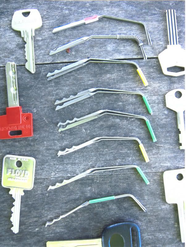

photo of Raimundo's picks
Postby Spossum » 17 Sep 2006 10:30
Thanks for the kind words Kaotik, but I am afraid I wasn't even close. Raimundo was kind enough to send me a photograph of his picks in the different stages of creation. He has also given me permission to post it, and he may comment about it. I have obtained some more bristles and will begin work on them as now I am not afraid of running out. Thanks again Raimundo, this was very helpful.

steps from the top down
Postby raimundo » 18 Sep 2006 11:47
from the top down,
1. cut two pieces about 3 to 4 inches in length, round off one end with a file on each piece, so that you will not have sharp things to cut into fingers. put these ends into a baby vise grip pliers end on, so that the depth of the jaw is the measurement for the the length in the jaw, the rounded ends are inside the jaw, the two parts are then gripped by another smooth jaw plier (allowing for slippage on of the wider radius to be all from the smooth jaw and the locking pliers keeps the ends together, bend the metal about 75 degrees, ( 90 degrees may be too much for some metal which will break, but by controlling the bend from both ends with pliers, you should be able to make them without much trouble.
2. put a ballpoint spring on the metal to hold the two ends you just bent together, be sure the smaller diameter is inside the larger one, you are making a matched pair. let the spring come around the bend. then clamp the locking plier hard keeping the two pieces aligned, about an inch or a bit more along the metal from the bend, use a smooth jaw plier to grip about a quarter inch or a bit more from the locking plier, giveing a length to apply the twist on, then put another ballpoint pen spring on the excess length of the metal to prevent splaying as you apply the twist. make the 90 degree twist cold, listen to the metal as you do this, any fracture will be caused by having the pliers too close together, and you can here it if it happens and you are listening for it. (throw out the metal if you hear and later inspect and find the beginning of a fracture, metal that has started to fracture is also weakend to almost fracture through the rest of the area. so don't waste more work if the twist fails, start over)
3. at the top of the photo, the two ends are cut to define the length of the pair you are making, and this work is done with a file and both pieces are cut together,
4 second set from the top of the photo is the first cut of the pick tip shape, a 1/4 inch chainsaw sharpening file is use, if you havent used a file much before, you should probably mark a center cut with the edge of a triangular file to guide the chainsaw file until it makes a groove of its own to follow. This is the last step where you will be working both pieces together, do not try to cut this groove to final dimension, there will be more work on it as you are finishing up, these first steps are simply wasting out some of the mass.
5 the third and fourth steps are all done on the piece that will become the rake, again, do not cut to final depth, just waste out some of that mass.
6 look carefully at the 5th pair from the top, part of the shaft of the rake has been mass wasted, the tips of the pick are still flat between the grooves of the chainsaw file. the undercut near the tip of the pick has been somewhat finished, while the undercuts of the rest of the rake are still unfinished, and the undercut on the single peak part of the pair is only marked with a centering point done with the edge of the triangular file.
the pair beneath that (with the yellow plastic keeper) shows both of the pair cut to a profile that may be now tweaked for dimension, the pick tips have been dressed to points, and the shafts are cut above and below. to make a slightly tapered shaft.
7. Not sure what to point out in that 7th pair, the photo is a bit muddy it may be where I was useing a very fine rattail file to skid along the sharp edges and make a bevel, its important at this step, to keep the file skidding and not let it stay anywhere long enough to cut a groove, do not use a flat file as the edges will dig in. The rat tail file has no edges, and I did say VERY FINE, I am using a grobet swiss 6th cut rattail.
8. this is a nearly finished pair, if you notice some finer detail in dimensions from the 7th pair, this has been worked out in the sanding. with the rougher grits the sanding is still a cutting and shaping process and should be done with shaping in mind.
9. Sanding with grits from 320 to 600 or so, wrap the sand paper around a stick that fits the job, round for the rounded areas, flat for the sides and shaft edges on top and bottom, keep the sandpaper on the stick with rubber bands, hold the stick and move the pick along it, making the file marks accross the the shaft, but just before moving on to the next degree of finer grit, finish by sanding at 90 degees to the direction of the tool marks that you produced with the first sandings. Always change direction 90 degrees before moving to the finer grit. do this by push pulling the pick shaft at the sand stic.
Ththethe thats all folks. :P
