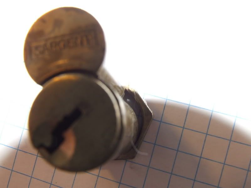

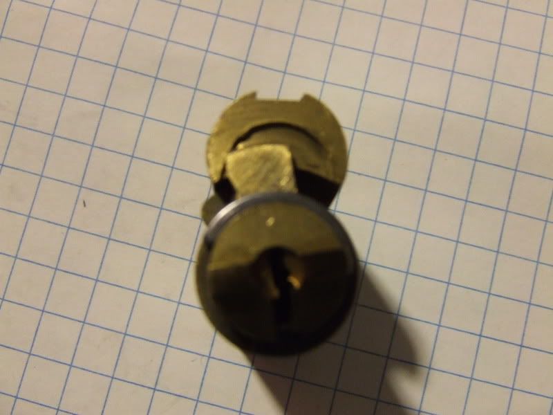

Postby unbreakable » 21 Oct 2006 21:26
Well, this is the only SFIC in my collection, but I think it is different in opertion than a Best or similar IC.
Heres the front (sorry for the shotty photo :o :lol: )
Here's the back. The nib that holds the core into the housing is retracted.
Here's the back again, only this time the nib is out, and would normally secure the core into the housing.
Here's a view looking down with the nib out.
And here's one with the nib in.
As you can see, the control line is only present in one pinstack.
To retract the nib, the lock ust be picked to the control line, and then rotated to the left (counter-clockwise or backwards.)
A quick Vid. It has been picked to the control line, and then rotated to show the nib retraction.
Does this explain what maybe happened?
