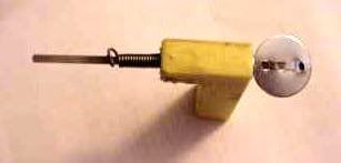

Here's my version of a home made plug spinner.
1 mouse trap spring
1 piece of wiper insert
1 piece of high density plastic
1 fender washer
Just give it a twist, put it in the lock, and let go of the washer.

Well, it's based off the original spring thing, but yeah, a new design and i like it. No more cuts or scratches from the old spring design, good job, thanks for sharing. I'll that try making one soon with what i can scrounge up.

Postby ComTech » 30 Oct 2006 23:28
Thanks!

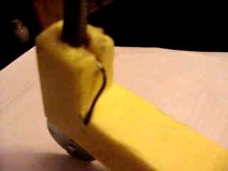

I drilled a hole a little larger that the wiper insert all the way through, then from the other end a larger hole to fit the end of the spring in.
I drilled 2 holes in the fender warsher just large enough to weave the wiper insert through.
If anyone has questions, or needs more photo's, let me know.
