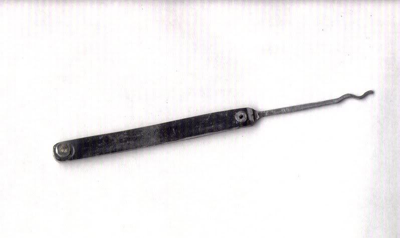

This is my first attempts to make a set that has riveted handles.
The picks have some defects from materials--the drain snake had rust and left pits which ccouldn't be polished out any further without excessive thinning and weakening the materials.
The bottom pick is a "snake" rake. This entire pick was slightly deformed (bent upwards) because I whacked the front rivet too hard during the peening process.
The new rule: Tap your rivets! Don't pound them!
The drain snake is .250" high and .025" thick. The smaller shiny picks (with no metal defects) have a height of only 3/16" but are the same thickness.
The metal on the "snake" is tarnished because I didn't take the time to polish them after annealing. To look nice to all polishing before assembly!
The spring steel has to be annealed or you can't drill the holes. hold the pick end in a vise when you anneal the handle portion--the vise will act as a heat sink and you won't have to harden/temper it. I used a #2 center drill to make the holes. The rivets also need to be filed flat to remove the hammer marks.
A last hint: the holes will NEVER line up perfectly or completely. Take your #4 round needle file, hold the two handles and the pick in alignment/together; look at the front hole and you'll see which drilled holes don't align. File the hole which doesn't align--it will be slightly larger, but it doesn't matter--the rivet will expand into the extra space. Do the front rivet first. Once the front is together, then align and file the inside of the holes for the rear rivet in the same manner. Rivet the back hole.

I don't like the flexibility (side-to-side) of the steel handles and wanted to make them more rigid. I made a set of picks with heat-shrink tubing handles, which made made them easier to hold, but didn't add any rigidity. I think the stiffer slightly larger (wider) riveted handles are easier to hold.
I'm still not satisfied with the way the "finish" of the handles look--the generally poor final polishing on the handles and tarnishing from heat--so I may cover these with heat-shrink tubing also.

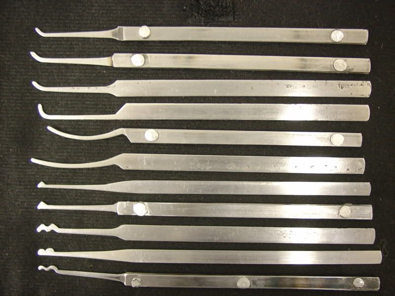

I'll give you a couple of hints that may help you if you try to do this again.
1. If you don't have a rivet set, make one. Its a pretty basic appliance, and it really helps to make the rivets even.
2. Use a cobolt drill bit to make the holes. Use a center punch on the anvil of your vice, or the plate of your drill press. If you have neither of these, find a thick metal plate to substitute.
3. Use that same anvil or plate to hammer the rivets on. If you have the rivet set, one or two shots with the hammer is all it takes.
4. Make sure the rivets don't come too far above the handle. File them down before you flatten then if you have to.
5. You can cheat, and get the really small pop rivets in the proper size. Remove the stake, and the use the rivet set to mushroom them over.
For a first try, thats actually pretty good. Especially since you are using plumbing snake. Just keep trying different things, and you will get what you are looking for. Eventually you will go from this:
