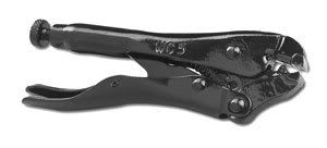

Lockmasters' Imp-Grip
Postby Peter Martin » 22 Nov 2006 14:19
This is a photo of the Lockmasters' Imp-Grip. I guess I just don't understand why this jaw shape would make it grip a keyblank any better.
Peter Martin
Posts: 396
Joined: 1 Aug 2004 0:14
Location: SD

Postby Shrub » 23 Nov 2006 8:19
Peter,
To me it looks like they have been designed to also acomodate lever lock keys, the 'V' on the bottom jaw being to site the round stem of the keys but i could be wrong having not seen them in the flesh,
The only thing ive seen was done by Jimmie at the dutch open, he notched the key bow a bit so the back of the jaws on the mole grips fitted in it, this stopped it moving in the grips,

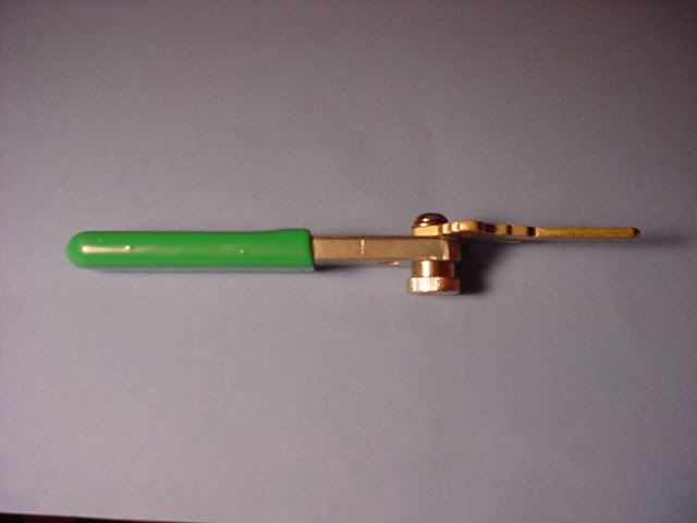

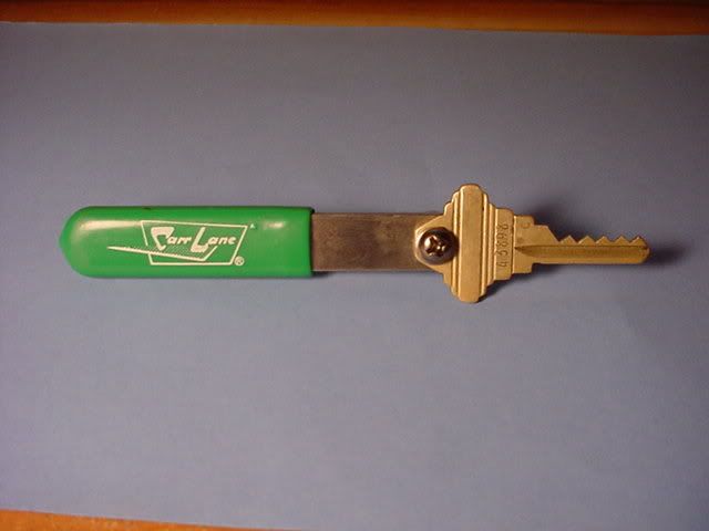

Postby Kaotik » 23 Nov 2006 17:52
Here's something I came up with, I had this handle that I didn't have any use for but I kept it just incase.
Nothing fancy but it works, and it might get some ideas flowing.
I also added a pretty thick piece of feeler guage so it will double as a small hand vice.
Kaotik
Posts: 1200
Joined: 10 Jun 2006 13:38
Location: Texas, USA

Postby Shrub » 15 Mar 2007 19:32
You have to tell me what a sludge is as that over here is what you call crap,
Kaotic, although perhaps a bit straight forward in the way he said it he has a point, its the same thing i thought of when i saw your pics,
Theres nothing to stop the key swinging up or down no matter how hard you tighten the screw you will still find the key moves,
I understand its an idea and a quick go at it so i can perhaps suggest an improvement if i may?
Simply drill another hole either side of the first hole, make these holes closer to the front edge than the first one and closer to the side edges,
This would allow you to use another bolt to go through each of the holes and act as a sort of stop for the bow,
Postby Kaotik » 15 Mar 2007 21:15
Shrub, I appreciate the suggestion. I thought of that at the time when I chose to use that handle, I just improvised by using locking washers instead of making such a modification. The handle already has two large holes in it, one in front of the other, and not much space to use for that suggestion. But thanks.
The image Romstar posted would do the same thing considering the rocking motion involved. Instead of having your hand positioned to the side, I thought the straight forward approach to more of an advantage.
