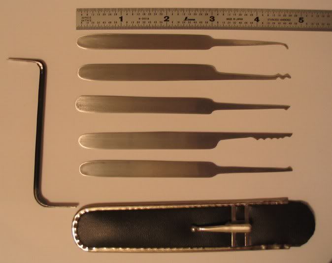

Sure you are referring to this set?
Postby gostone » 2 Dec 2006 14:48
I have seen other DINO picksets like the pen set, but these seem like superb tools. I like the idea of the modular handles, I wouls assume I could remove the tips. As I would like to use the handles for some of my own pics.

Postby Romstar » 2 Dec 2006 16:05
No, you can't remove the pick heads. Thats the problem. The Dino version are riveted in place. I haven't actually seen a real one up close.
As I said in the other thread, I designed those things, and was looking for someone to make them. I made a prototype, and had a few sketches. Obviously someone liked what they saw.
What they didn't know is that my handle is one piece, and uses a small plate held down with two screws to hold the pick head into place. This allows the heads to be changed if they break.
The two screws make sure that the head doesn't wobble while picking, and the plate helps in tactile feedback transfer by spreading the load of the screws across the entire base of the pick head.
It was designed to use pick heads similar to those used in pick guns.
The moment I saw them at Lockmasters I was ready to kill someone. It was one of the few totally unique designs that I had, and some bugger ripped it off. The worst of all is that I think they may be getting a patent on the thing.
Anyway, you can try them if you like. I have only spoken to two people who have used them, and both of those people had complaints. Like anything though, its all about preference.
