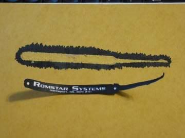

You could try using Elmers Stick Glue and then take your template and turn it upside down. Rub the glue onto the back of your template and make sure you get the edges. Then take your template and stick it to your piece of metal. Then take a black permanent marker (Sharpie) and start on the template and draw a line straight off the edge of the template onto the metal and keep doing that until you've gone around the whole template. Then peel your template back up and you will have a reverse image of your template on the metal like my picture. The glue pulled up some of the cardboard backing on my notebook, but on metal it will be fine. Then just grind away all the metal that has black marker on it and what's left is a pick. Then you can sand the glue off if there is still any on your metal.

ok I will try that exept I have black hacksaw blades but I think a silver or white sharpie should work, thanks all

I have never seen a white Sharpy marker but a silver one will work fine. you could also use something sharp to scribe a fine line around the template leaving a thin matallic line to follow.

After removing the paint (if needed), clean and degrease the blank.
Attach double sided tape to the back of a printed template of the pick and attach to the blank.
With a sharp craft knife, cut through the printed template and tape layer and remove the inner pick shape. Use a permanent marker pen to fill in the space created.
Remove the printed template and tape layer and a perfect pick profile should be left on the blank. :)

zerg49 wrote:ok I will try that exept I have black hacksaw blades but I think a silver or white sharpie should work, thanks all
Just use sandpaper on the blade first and the black will come off.

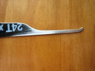

Thanks all and I think jackbeef and I buy the same blades, because thats exactly what mine look like, anyway I just have one more quick question, is it helpful to make blanks before making the rest of the pick or can you just start with a normal blade (in my case a sanded blade) and just grind or is it helpful to cut out blanks before hand? , Thanks again

I just snap it to the length I want and start grinding until it's done. But, I do the shaft first and the tip last so I guess somewhere in the process it becomes a blank, but then quickly gets grinded into the actual pick. I use a bench grinder all the way until it looks like a blank, and then use a dremel for the tip.
