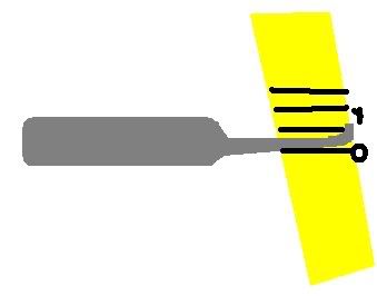

OK. So. I'm not exactly sure how to phrase this, because I'm not well versed in the lockpicking jargon. So I made a diagram. XD
When I say "Curvy end," I don't mean the handle. I mean the part where, on many diagrams the pick would look upside down. The curve.
All the lock diagrams I have been reading show that you touch the pins of the lock with the pointy part, the tip, of the feeler pick. (Please refer to my diagram. I know its bad, but I'd really love it if you had any idea what I'm trying to communicate.)
For many, many hours I had tried to pick with the pointy side of the pick. I can't do it that way.
Then, I wasn't paying attention, and I put the pick in the way that I percieved it to be upside down, where the curvy side, opposed to the point, was facing the pins. AND I picked it with the curve.
I tried again, and I picked it with the curve. I can't pick it with the pointy end, only the curvy side.
And now I wonder, are we supposed to use the pointy side of the feeler?
Or...
Are we supposed to use the curvy side?
Is this a weird thing?
I can't believe I'm going to ask this, but what side of the pick are you supposed to use, exactly?

You usually want to lift pins with the pointed tip of the feeler pick. I'd say you got lucky and the key profile is probably kind of similar to the shape of the backside of your feeler pick.
Some locks are just hard to pick and you may have one of them. Lifting pins pin by pin can be tough on some locks. When manufacturing tolerances are tight, locks sometimes just don't want to yield. Don't let it discourage you. Try another lock, you might have more luck.
Here's something that made my feeler picks more useful: I filed a very small notch in the "pointy end" so the notch will fit right on the tip of each pin. It helps me get on the pin and stay on each pin.
Other than that, light tension, and patience is all you need.

Aponi wrote:OK. So. I'm not exactly sure how to phrase this, because I'm not well versed in the lockpicking jargon. So I made a diagram. XD
[img-]http://i221.photobucket.com/albums/dd72/APONI/pcikquestion.jpg[/img]
strange things sometimes happen, for instance, George Bush being elected twice... but as someone else said, it was probably luck.
Are you using home made picks? If so, your hook tip might be too high and you are overlifting your pins. Or, you could be putting the pick into a very small keyway like the kind on the back of a Master combination lock, which norally requires slim-line picks, with thinner profiles of the usual hook and snake shapes we are used to.
To some the bottom line is, open the lock, no matter how you do it. I've definately used my picks unspide down on purpose to see if the key bitting (the peaks and valleys) could somehow be duplicated by inserting my W style pick upside down into the keyway.
When you are picking, are you diong light tension? hard tension? are the pins staying up when you use the tip of the hook? or are they all falling down after you press them up? I remember when I started I used too much tension, and I even bent tension wrenches and my finger would go white from pressing so hard.

Your pic of the lock is actually a bit off. The 'cuts' where the key pins and driver pins meet should be below the shearline (unless something, like a key, has been inserted into the lock). You probably realised this, but just in case you didn't :P .
And yes, when I put the pins up, sometimes they stay up and sometimes they come back down, very loosely.
Unless you're applying too much tension, all the pins that you raise with your pick should come down 'loosely' exept one. That one is the bindingpin. That's the pin you should try to set, as that's the pin that's taking all the tension at this point. After you set that one, another one will bind. So if more than one pin is 'not' coming back down 'loosely', then you're using too much tension. Ignore the pins that 'come back down loosely'; once you get to the one that doesn't and feels like it's 'stuck', that's the binding pin.

Honestly, there are all kinds of stupid ways you can pick a Master #3. The upside-down hook thing works on other locks, though - I have a brass Brinks where it's the fastest way to pick it.
For a beginner, getting the #3 open isn't so much the point - it's doing it in a controlled manner where you know what's going on in the lock at each step.
Also, most people call that pick profile a hook, but we all know what you mean.

Hi Beff, Welcome to Lockpicking!
Don't worry about your jargon, we all know what you mean, we've been
there too!
You call your pick a "feeler pick", that's a pick with almost no hook on it!
(1-2mm)
A "small hook" has slightly more hook length on it! (3-4mm)
And a "long hook" is more or less like the one you have painted! (5-6mm)
Sometimes it's more easy to pick a lock with the pick upside down, that's
why different types of picks were invented!
Also don't neglect that psychology can be playing with you, you think you
can't, and therefore you can't, then you turn the pick around, and with
renewed faith, you're able to pick the lock!
On the other hand, telling yourself that "hey I know I can pick this lock"
can give you problems too!
I think being humble, when it comes to lockpicking, is the way to go!
Other people may have other opinions!
So back to the topic, what pick are you "really" using and where
do you put your tension wrench with that self same pick?

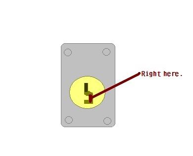

I put the tension wrench in the keyhole, at the opposite end of the pins, where there is a ward.
Right here...

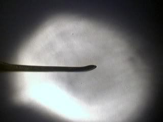

Aponi wrote:I'm not sure if it is actually a feeler pick or a small hook.
Nevermind that now, the important thing is that you can lift one pin at a
time, if you're SPP that is!
Also, I might have a different view about what a feeler and a small hook is!
According to the description this is a feeler pick, but to me it's a small
hook, my feeler is much lower
My feeler pick!
Don't get fooled by the size, it opens 95% of all the padlocks,
in less than 30 sec.
Aponi wrote:I put the tension wrench in the keyhole, at the opposite
Ok me too, but you see, there might be a small problem here with the pick/
wrench combination, cuz the wrench takes away the space of the pick!
Unless the feeler is very low, try a top wrench!

Postby Afisch » 5 Dec 2007 14:41
I think what they have classed as a feeler has quite alot more hook on it thanmy short hook, which is closer to what you have as a feeler pick. Then again mine is post being sanded.
I started almost only using the short hook. Now I mainly use a long hook, but it doesn't seem to have much more of a hook on it then 3mm, so who knows...
