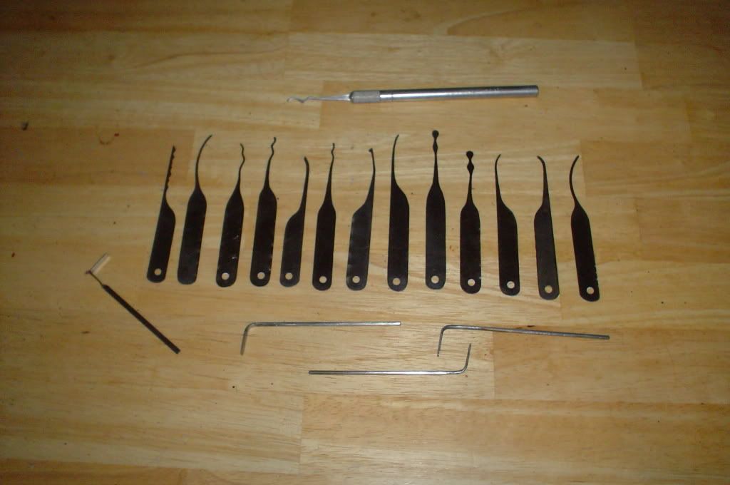

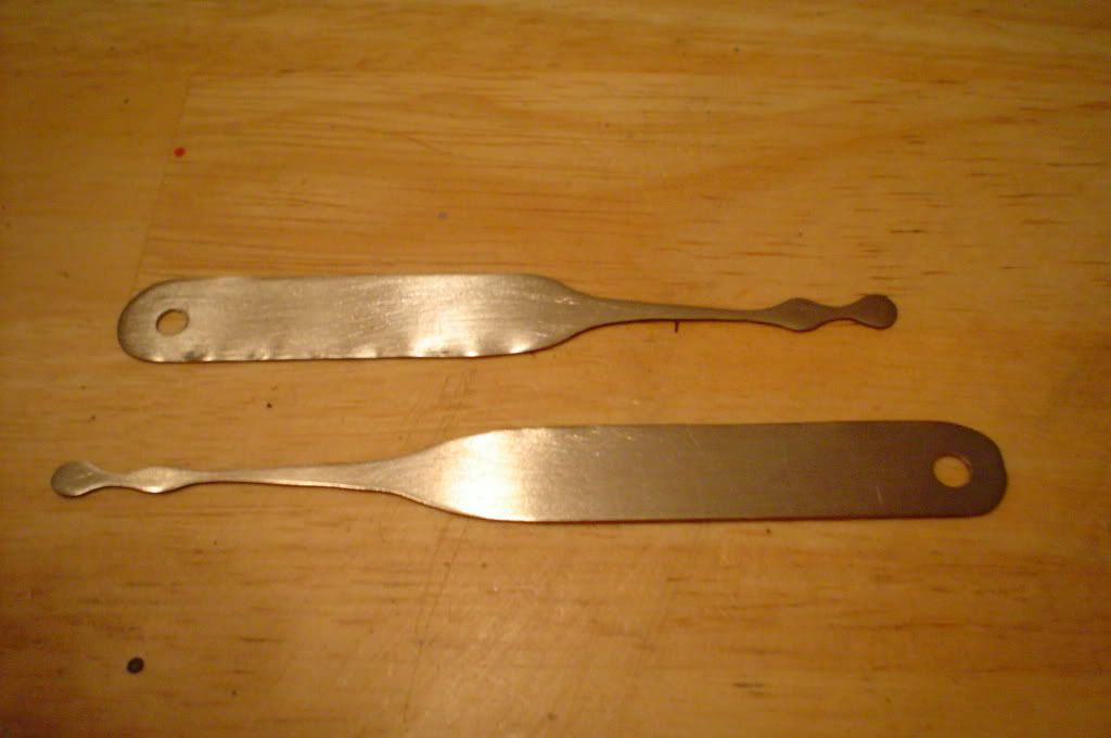

Here are some pictures of my homebrews and where i learned to make them...
this is most of my homemade set, all except for the twist flex tension wrench

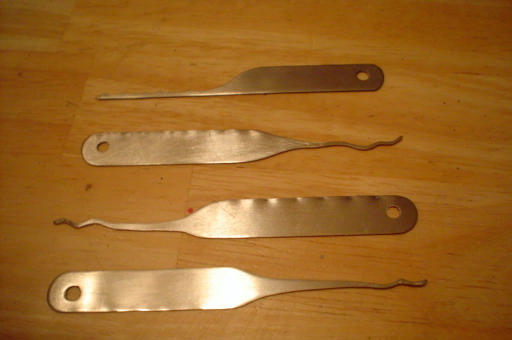

close up of hooks

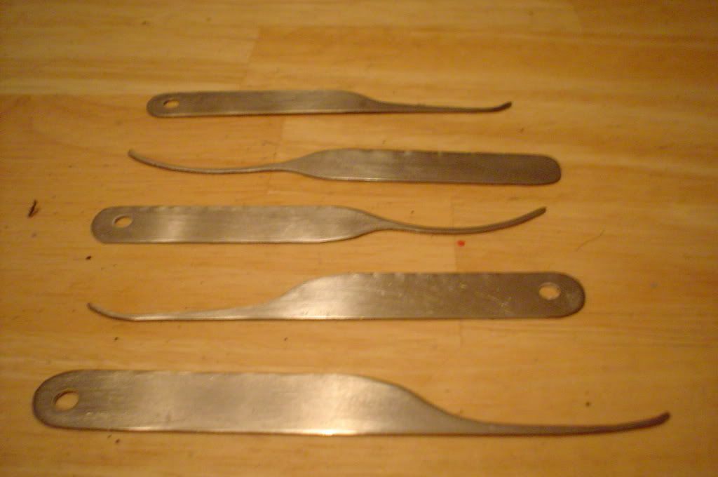

close up of rakes

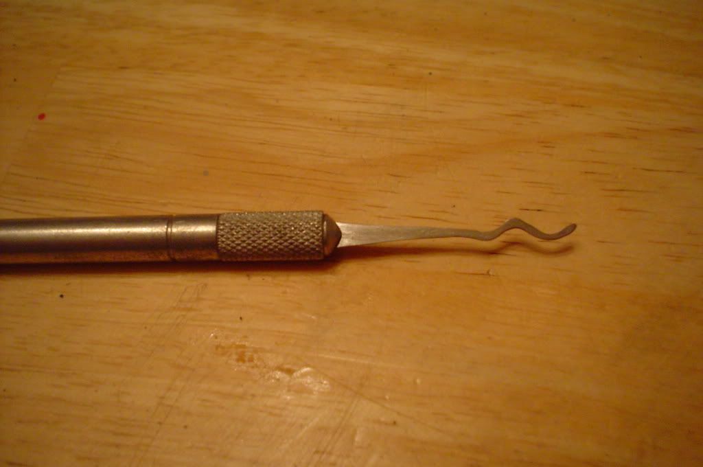

attempt at ball picks, actually work well on car doors
modified diamond

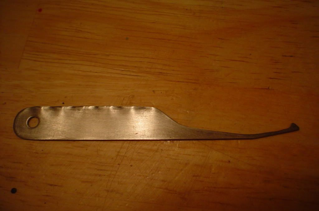

exacto rake

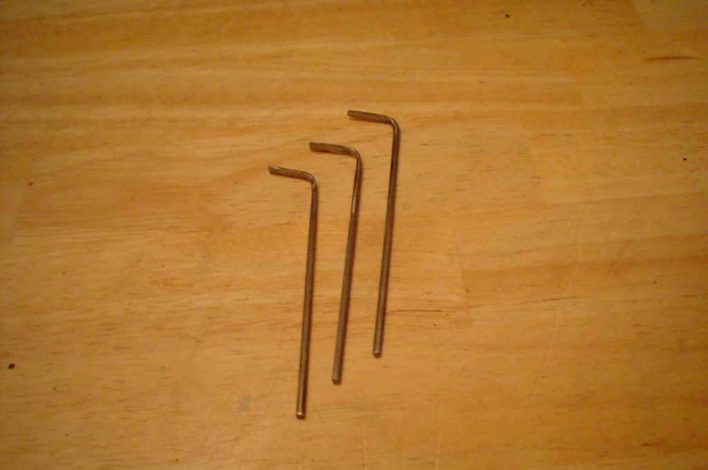

last but not least... a couple tension wrenches, look the same but have different thicknesses, havent worked on a "wishbone" type tension yet.
all of these tools were hand made using hacksaw blades and coat hangers... picks were made with a bench grinder and and tri-file, i dont use templates... although i do look at them and kind of wing it :wink:

the tension wrenches are actually something i came up with on my own... it might already be out there but i couldnt find it so its mine. they are coat hangers with smashed tips, bent over and tempered, and work pretty darn good.

just realized how crumby the close ups make the picks look... havent gotten a chance to polish them, but did go over most of em with a 300 grit sand paper

Postby Eyes_Only » 1 Jan 2008 8:33
Nah, they actually look real nice. You just gotta grind away the saw tooth or add some handles so you wont cut yourself. I really like your tension wrenches. Are those out of bicycle spokes?
Postby gstrendkill » 1 Jan 2008 23:06
nice pick set, i just might try your method of torque wrenches soon

Postby DiamondHead.exe » 8 Jan 2008 0:55
Thanks for posting dude, these remind me of my first set, everything was as slim as possible and still looked like hacksaws.
The only problem you might have is them bending or breaking.
I really hope you tempered them well.
Make sure you lube and polish them well.

Postby zsoutendijk » 12 Jan 2008 8:50
thanks for all the kind words everybody, i tried bike spokes and they work pretty good too.
