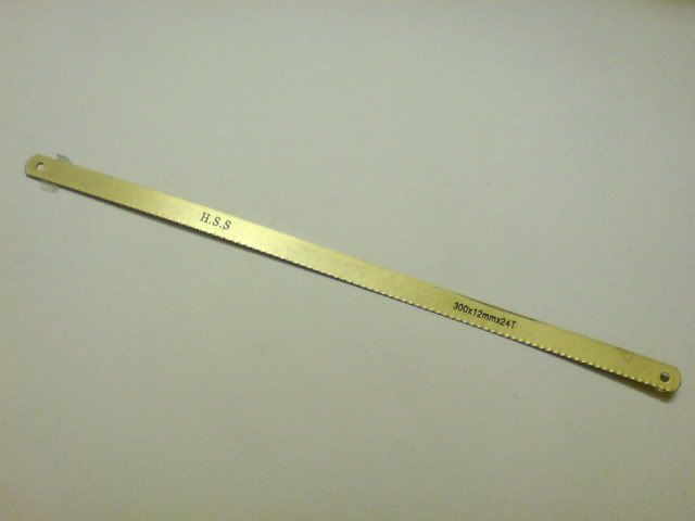

First we get some hacksaw blades. I have experimented with many different varieties but these ones seem to be the best. They also happen to be the cheapest. You can see that they are not straight. Clearly when they are put in an actual hacksaw under tension they will straighten out, however I need to choose the straightest bits out of them to begin with.
http://i242.photobucket.com/albums/ff164/DuelODDity/lp101/makingpicks/rawblade2.jpg

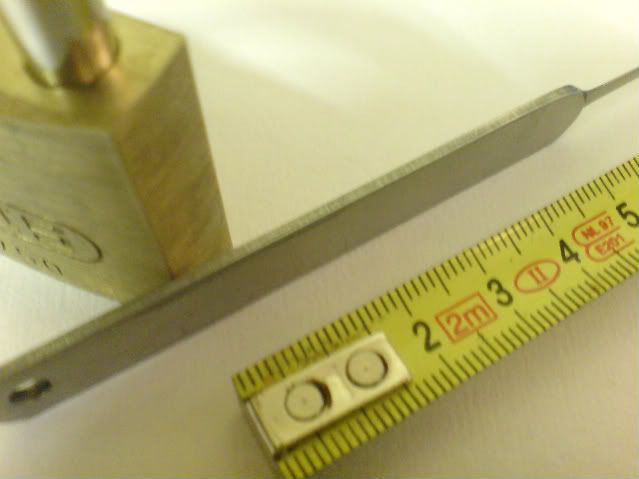

Just over 1/3 of a blade seems to be around the right size.
I grind the blade down using the eye as a guide basically leaving a little bit either side of it. I've also drawn lines to give an idea of how long the shaft needs to be.

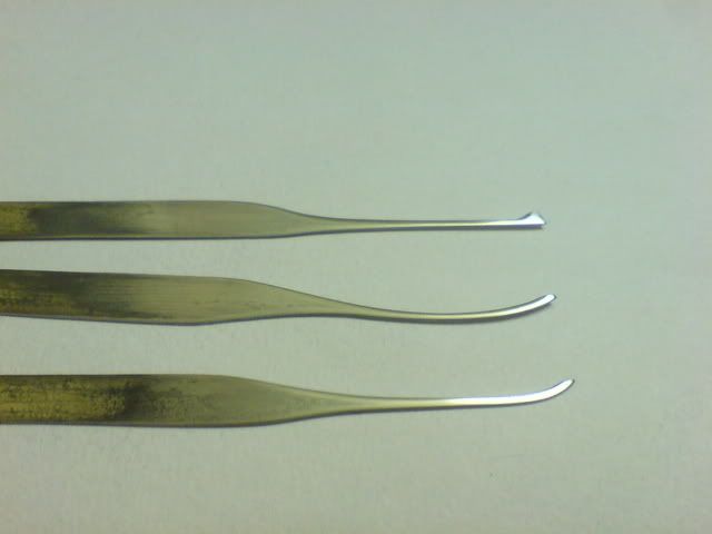

After just one going over with 240 grit we can see what we're dealing with and they start to look much more like proper tools instead of ground bits of metal. I find that the sides are the easy bit but special attention needs to be taken on the top and bottom as these, after all, are the bits that will be gliding smoothly against the plug and under the pins.
http://i242.photobucket.com/albums/ff164/DuelODDity/lp101/makingpicks/after240.jpg

The finished article! Now you can go one of several ways here; You could sand the whole lot to make them thin and pretty or, you can add handles. My personal favourite is to cut a couple of other hacksaw blades to size and stick them either side with epoxy resin. This needs to be clamped almost overnight for it to dry and then sanded down for a good finish. It makes for a solid pick with great feedback, however here, as I'm all out of blades and happen to have some hot orange “sculpy” I'm going to use that. Like FIMO sculpy is a bit like clay and can be moulded and shaped before you stick it in the oven for quarter of an hour, after which it sets pretty hard.
http://i242.photobucket.com/albums/ff164/DuelODDity/lp101/makingpicks/after400.jpg
