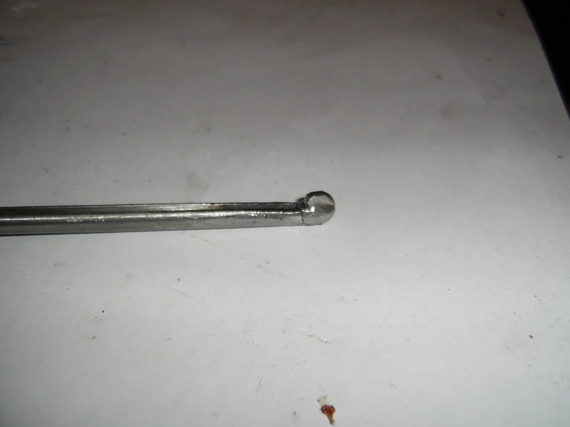

OK folks, I've been working on this for about a week and I reckon its all but finished.
Let us know what you think.
Image[/

Postby huxleypig » 1 Mar 2009 0:16
Sorry for the slow reply guys, I've been pretty busy.
Well firstly, its for curtained mortice locks (maybe should be in the Euro locks section - whoops) and it does indeed work. I opened a 5 lever earlier tonight. Unfortunately it only fits 5 gauge (5.2mm diameter) locks but I'm working on the 7 gauge (4.3mm) as of Monday. Equivalent commercially available tools like this are at least £150 so I've saved quite a lot.
After doing the 7 gauge I think I'll experiment with a multigauge tool. I'm thinking a tapered bar with notches cut out to tell you when you've got the right section in. Might go with a 'T' shape for the turner too. This homebrew stuff is loads of fun aint it?!!!!

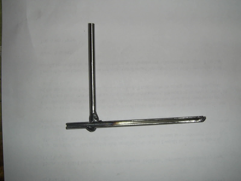

Postby huxleypig » 29 Sep 2009 6:44
Sorry for the mega slow reply!
This one is made from 5mm stainless steel bar with a 2mm furrow cut out of it, about halfway into the bar. It can be as long as you like.
Blob of weld on the end, filed to suit and then another bar welded for tension application. Finito!
Then 1.6mm wire bent for the wire pick.

Postby exspook » 1 Oct 2009 14:45
What did you cut the groove out with?
I know how these work and this is a great simple design, have you made wires for opening from both sides of the lock?

Postby huxleypig » 20 Nov 2009 9:43
Yes mate. You just bend them whichever way you need to. Dead easy.
Check out my whole collection now:
The allan key ones are simple yet good.
The grooves were put in there using a slitting saw (I think). Just a blade that jou can control its depth with.

Postby huxleypig » 20 Nov 2009 9:45
Real image here!:
