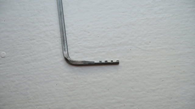

I decided to make a Best style core-removal turning tool specifically to fit the E keyway. Because the E keyway is wider than others at the bottom thin tools tend to roll over and require an extra pick or toothpick to hold them straight.
I used a cut off piece of an electrician’s fish tape. It is .125” by .063”. I filed an angle on the top half and flattened the bottom until it would just barely fit into the keyway. It is a tight fit. I then marked the tool through the holes of a core with a fine tip marker. I then filed away the metal between the marks. I then cleaned off the sharp edges.
It now fits into the keyway easily. Due to the thickness, it does not roll over when applying clockwise turning pressure and turns full force on the control sleeve.
Raymond

Postby Raymond » 17 Dec 2010 22:40
The biggest problem with trying to use a bump key on an SFIC lock is that it has no shoulder at the bow. The tip of the key stops in contact with the plug retainer. Bumping against the plug retainer will break off the lip from the plug. This renders the core unusable.
However, applying your idea to a key that has been shortened so that the bow stops at the face of the plug just might work.
Raymond
Posts: 1393
Joined: 18 Jan 2004 23:34
Location: Far West Texas
