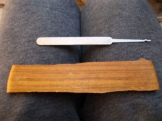

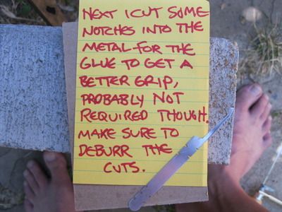

Hey all i wanted to add to the awesome collection of how to articles on lp101. I will be showing how to add a wooden handle to your picks. This works with picks that you make or purchase. The wood i'm using in the tutorial is teak and came from some bit of home decor i purchased for $ .50 in a thrift store. I dont have a pic of its original form and i dont know what it was, but it was about the size of a large salad plate. Starting with flat, rectangular pieces of wood would be ideal, but i was going for cheap!
These first two pictures are showing what i was starting with, the picks are just there for scale purposes.

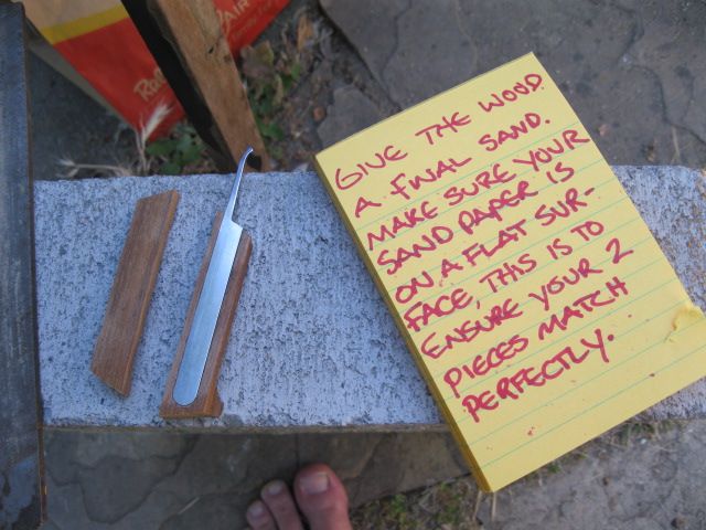

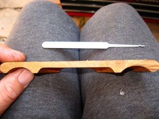

this is the pick i'm putting the handle on and the instructions:
I tried using a dremel attachment to hollow out the handle area, eventually i just put a chisel edge on a flathead screwdriver and carved out the channel like that. Taking a little at a time and checking the fit often i ended with a tight, flush, fit between the original metal handle and the inside of the custom handle.

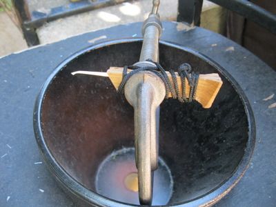

and clamped:
http://i1249.photobucket.com/albums/hh5 ... 1342489722
as soon as i have the pick properly finished i will post some photos. I'm really not happy with how it turned out, actually. The pick i ground out of a broken key extractor and it turned out so free king AWESOME! (thanks to Romstar for the stencils) The finish is superb (thank you, Raimundo and others...) but the handle is sort of short and it reminds of a paring knife somehow :oops: . Structurally it is very good, the handle is so solid, good feedback and its never coming apart.
Give me a day or two and i'll show the finnished pick, i promise.

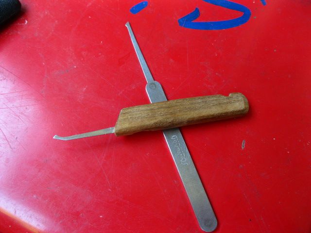

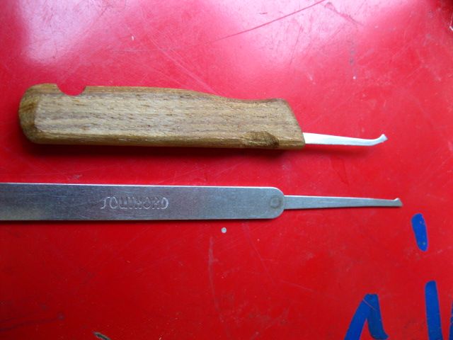

mostly finished...

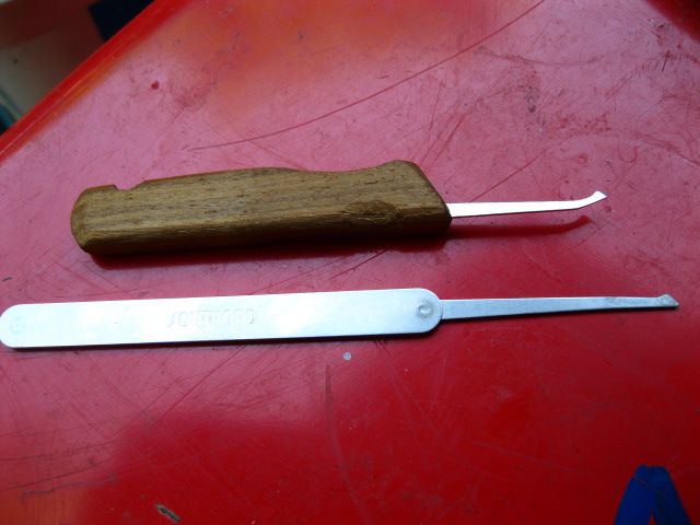

Postby atticRR » 16 Jul 2012 21:17
aaaight, here it is. it took A LOT of filing and carving to get the wood down to a reasonable size/ thickness. During the process, using files and razors, I screwed up what was a perfect finish on the metal of the pick. Pre-woodworking, that thing caressed its way into the lock, bumping softly over pins, sliding seductively along wards, until-POP! the lock opened. Now its like an average store bought, home polished pick-good, but not at all like before :cry: .
Suggestion: Cover the exposed part of the finished pick with something tough, like duct tape, prior to filing and sanding to protect it. (definately do all the metalwork before mounting IMHO)
Also: make sure your handle isnt all short like mine. This pick still works great, i sure wish the handle was longer though.
At long last here it is:
I want to finish off the handle all the way, realistically i might not though. Its likely ill use this one as is and make a newer, hopefully better, one. Rest assured, if i make one and it has a wood handle using the technique above (which i think is a good one) i'll post it here.
Thanks for watching, any and all criticisms or comments are always appreciated.

Postby Legion303 » 16 Jul 2012 22:04
Very nice writeup. I would try to make the wood conform a little closer to the metal so it doesn't end up so wide, but I admit I've never tried larger handles like that, so they might work great as-is.
Stickied.

Postby atticRR » 18 Jul 2012 8:41
wow, thanks legion! now that its stickied i'll have to reform this pick some more! i agree that it is a bit wide, its not too bad though.
Will definately be updating this section, recently got some pretty nice walnut thats begging to be made into a handle!
