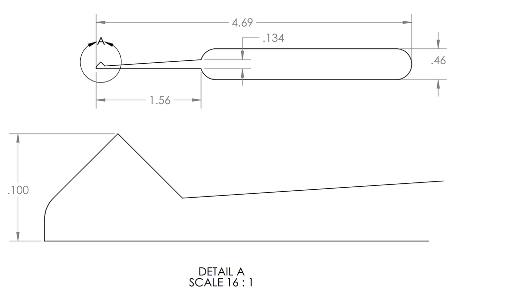

I wanted to submit something for peer review. My hobby of lockpicking has been passed on to an engineer who I will be making a set of lockpicks with using a wire-EDM (WEDM) and a laser engraver printer. Some of the design elements are experimental so I wanted to see what the community thought of these ideas. Pictures are included at the bottom of the post for ease of reference. Units are in inches.

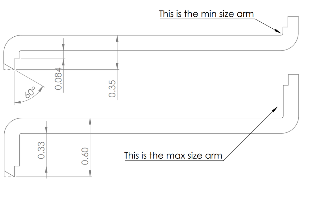

We currently have drafted seven tensioners, each having a chamfered end and a square end. The idea of having a chamfered end is so that there will be less surface area for the tensioner to bind up the front pin (this has not been prototyped, does anyone have experience with chamfering TOK tensioner to reduce front pin binding?) The arms of the seven tensioners range from 0.34" to 0.60" in length (the attached PDF shows the shortest and longest tensioners)
All diamond picks have been modeled and range from a bottom of pick-to-top of diamond height of .05" to .31." The increments between heights are different for picks in ranges 0.11”- 0.31” (0.03” increments) vs ranges 0.05"- 0.10" (0.01” increments.) Note that the toe of the diamond pick has truncated and rounded. The theory behind this design is if the pin behind the one you are picking is already set, you will be able to raise the target pin higher without interfering with the set pin. This has been prototyped but I don't want to influence comments by relating the results. With regard to the height increments, we want a way of decoding the approximate pin depth so that a key can be easily made once the pin(s) has/have been set. Doing this with hook picks would also allow a pin-depth decoding with hi-lo combinations.

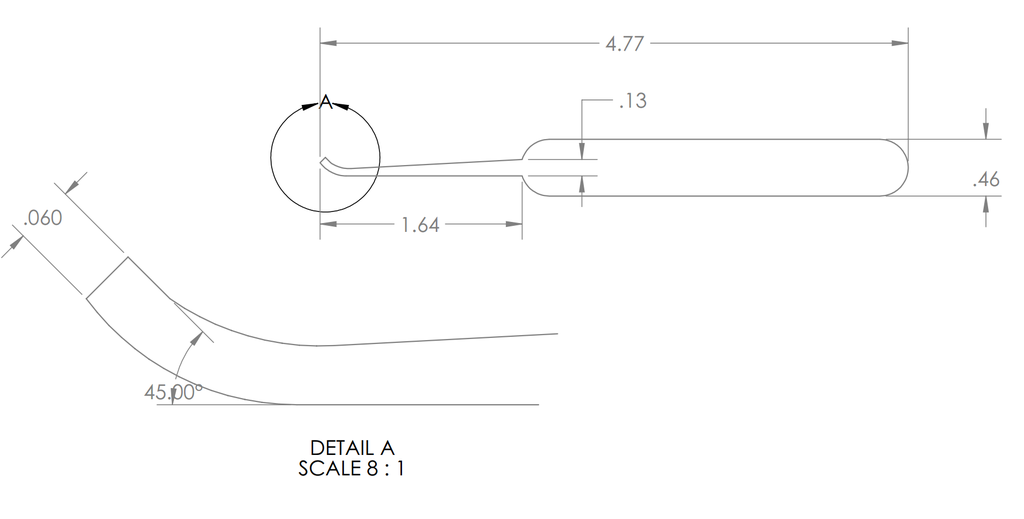

We plan to increment the hook picks with a maximum height of 0.028. We haven’t decided on a diamond profile on the picking surface (as with a Peterson Gem) or a rounded surface with maybe a tiny dimple (like a hybrid between the Peterson lifter pick and Peterson reach.) Again, this has been prototyped but results are not given at this time so as to not influence feedback. We haven't agreed on an ideal angle for the hooks, but are currently discussing a different angle for each hook height (suggestions?)
