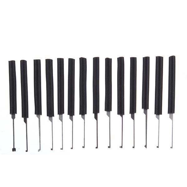

I've had my goso dimple pick set for a little while now & i hate it. I figured that since i had good luck with there regular pick set that there dimple set would not be to bad either. WRONG! all of the shafts going from the handle to the tip of the pick are .047 thick so its a pita to even get them in a lock. I looked around & could not find much so i wanted to ask if anyone here knows where i can buy a good dimple pick set. I know about using a half diamond & that works very well but sometimes i cant get around warding to set a high pin with my half diamond. I really dont want to sand down the shafts of all these tools or make my own because of the time involved. (Why spend all day working on a $20 pick set) So my question is who makes the best dimple picks that i can buy?

You can sand/file those Goso picks down and they'll work well for you. If you don't mind paying for it, you can get the SpooXe kit - where the handles have been replaced and the picks have been finished nicely. I think BosnianBill did a video on it. I've modified a couple of them, and it's really not too much work.

Ive been using the souber picks. They are quite a bit cheaper than spooxe. They work great. I did recently order the goso 14pc set, to have a go at making my own spooxe set too.

I hear you. Goso makes 2 different sets & i think this is the one spooxe uses its $13.88 U.S. shipped from bandgood. Just sand the plastic handles down smooth & the handles would be simular too, i think? Compare this to the $149.50 U.S.+ shipping for the spooxe kit & the difference is drastic. Idk if spooxe ships free but even if they do its a difference of $135.00! Thats alot of picks & sand paper. It would be nice if there was a pick shop on this side of the pond that offered a kit similar for a better price. Your rite about it not being to hard either, i made these in about 1 1/2 hours. Once you do one and get the hang of it the rest are alot easier.

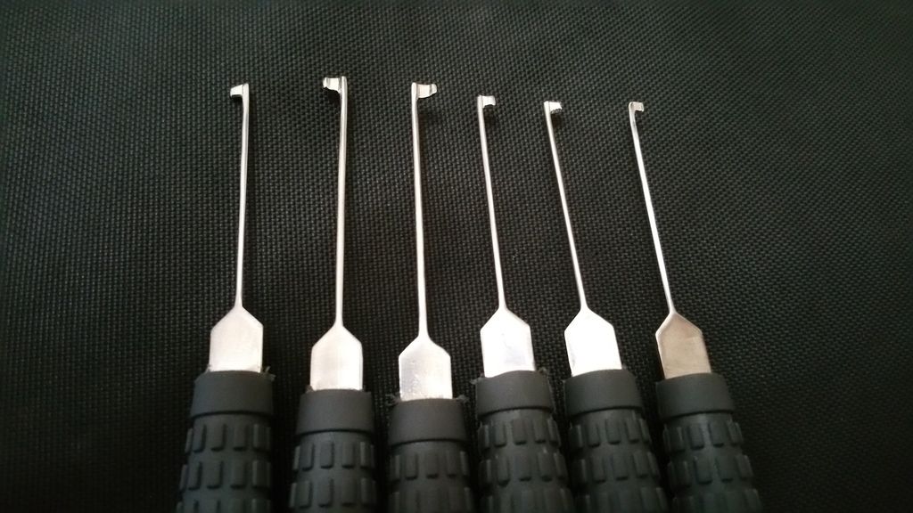

Postby OrMeanGene » 5 Apr 2017 18:45
Here my first homebrew spooxe type. Used goso as well.

Re: Dimple pick set?
Postby Ralph_Goodman » 6 Apr 2017 11:34
OrMeanGene wrote:Here my first homebrew spooxe type. Used goso as well.
Looks good. How is it working out, picking wise?
Does it stack up to the goso?
Ralph_Goodman
Posts: 255
Joined: 2 Oct 2015 12:25
Postby OrMeanGene » 6 Apr 2017 13:39
Didnt use yet. Just made when posted. I made another after. Both are curved picks. They feel great. Ill post after i use later on today for function
