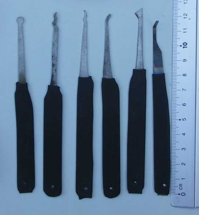

by MeRZHiN » 27 May 2005 13:50
First of all: critique is HIGLY appreciated  . and i also wonder or the sizes are right... i'm not really sure  . But now, let's en the babbling, here they are:

OMG those are your tooth picks?!?!?! I feel like I'm getting tetanus just looking at them.
OOOOoooohh There lockpicks, not bad, not bad at all, at first I thought they were Tooth Pi(ducks)

by MeRZHiN » 27 May 2005 14:09
yeah, real rusty  made them of some broken sawblades i got in school, asked the teacher to hold on to them for me. it works

by digital_blue » 27 May 2005 19:44
Since you're asking, I would say the shapes look like they'll probably work well, but the picks are in serious need of hand sanding. Get yourself some 150 grit and 600 grit sand paper and go to town with them.

by Mad Mick » 27 May 2005 20:46
Nice set. The lengths look ok, apart from the last pick on the right...the transition from the blade (shaft/shank) to the handle should not interfere with any of the front pins, when reaching to pick the rearward pins. Apart from that, good work. As suggested, a little sanding to remove the egdes would be preferrable also.

by digital_blue » 27 May 2005 21:17
Isn't the last "pick" on the right a tension wrench?

by stick » 27 May 2005 23:06
Yeah. It's a little hard to tell, but looking at the shadow, you can tell it sticks up. Its a tension wrench.

by MeRZHiN » 28 May 2005 3:37
yep, it's a tension wrench. i took the picks from above and the tension wwrench was pointing up. Problem is i use my dad's camera and he won't let me use it much  . THX for the feedbacks guys!

by cracksman » 28 May 2005 21:28
Looks like a nice usable set, they could use a polish, belief it or not I finish with a 2000 grit sandpaper (u get it at an automotive store) and I a high quality gun oil to wet sand it (I know I'm a bit anal) but it is very smooth. Also to get a taper front front of pick to back I usually vice the pick with what I want to remove showing (I happen to have a set of digital callipers which helps) and hand file the pick-it gives a nice straight edge.
