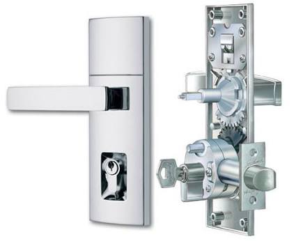

Inventory, I know you hate my rants, but lookie what I FOUND !!!
Anybody remember these things? It's a Weiserbolt. This unit combines a deadbolt with a latch. During the day or so when you want it unlocked the latch goes in and out like a normal latch would. Works well. When you want it locked, you turn the inside thumb turn in the center of the knob, and the bolt extends out a full 1 1/4 inches! One hole two locks. Super idea.
So what happened to it? Last time I saw these in the catalog had to be a good 10 years ago and they were then $145.00.
Okay here is the rest. We sold quite a few of these when they were still around $75.00 - keying these units was a nightmare as this thing has a super fussy internal timing to get that bolt to extend with the key, and also to work properly. It had a tendency to jamb up when not timed correctly.
The latch plate was super large and had to be drilled about an inch and a half into the jamb. Four three inch screws held this thing on the wall. It used #3 Phillips which meant it was a 1/4 inch screw.
In the end, it was too much for most smiths to key. It was too much for the public to buy when you could have a normal deadbolt for around $10.00 or so. Just a lock ahead of it's time.
One more - this thing is basically pick proof. It uses that Weiser "E" line trick to open, and if you don't know that one this will never roll over, well the keyway will, but the lock won't.
Just enjoy something from our past, and a reminder that everything under the sun hasn't been seen - - at least in ages anymore. BUT I have one!

HATED those things! Corbin made a leverset that was similar, also a nightmare. On the Corbins the latches were HANDED, too.

I had to install the Corbin/Russwin lever ones on every interior cylindrical lock of a 19 story building and master key them and they were all IC core! Not a fun job. Very finicky to install.

Yup it was a pain to pin these things, but we SOLD quite a few of them. For that matter, I even made a 5 inch backset for one. Had to cut the latch and weld in extra strips of metal to extend the assembly. Worked well, and as far as I know it is still on the door.
Sidebar to this, several of the condos in this complex have them on their doors, installed by us, and they are happy with them. SO in a way I still service the things.

Please confirm for me, as from the looks of that lock
That its latch/bolt is not deadlatching(doesnt have the little halfmoon)
And therefore really only locked(the bolt) when thrown the extra 1 1/4 inch
If im right that lack of deadlatch (which i find on cheap entrance sets ) may be why the design has fased out

Yup, the thing does not have the half moon deadlatch mechanism. When locked, it throws a 1 1/4" bolt. Deadbolt.
The reason it was dropped it got way too expensive for the public, and it was a pain for most to work on.

Sinifar wrote:Yup, the thing does not have the half moon deadlatch mechanism. When locked, it throws a 1 1/4" bolt. Deadbolt.
looks like its a
Similar mechanism to
Gains borough Trilock
Which is insecure when not deadlocked with the key
