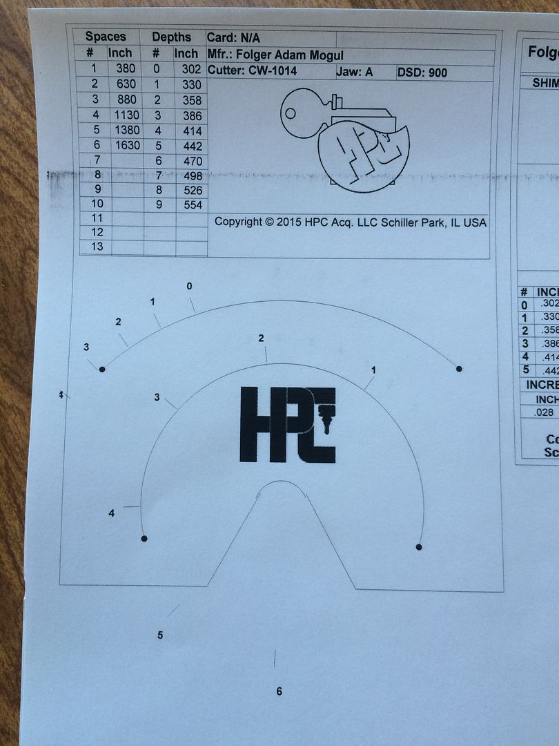

Postby GWiens2001 » 18 Jun 2016 15:51
Here is what a card for a Folger Adam Mogul cylinder would look like:
Instructions on how to do the custom card to follows.
Re: How to make a custom card on CodeSource?
Postby RumballSolutions » 18 Jun 2016 17:32
I understand that it's not an "ideal" situation, but what if you translated your spacing to "tip spacing" and set your card up that way?
Yes, it's a bit of a pain, will require some quality time with the calipers and will not be as accurately repeatable as shoulder spacing, but it will take the large bow size out of the carriage travel/arc, allowing you to reach more of the blade where the cuts are.
In so far as the depth scale, I can't offer much more suggestion than trying different diameter cutting wheels in the HPC, but obviously you would have to play trial and error on the cut angles.
It's a lot of set up time, but once you get the measurements down, I feel you could get reasonable results.
I guess the only other alternative is to find someone with a computerized code machine and have them cut a set of D&S keys for you. Then you can just cut your keys on what're duplicator. Old school but still useful.
Postby GWiens2001 » 18 Jun 2016 18:48
The distance the key needs to travel while being cut is what makes it not workable on the machine. Now I understand why they make/sell a key specifically for cutting Folger Adam keys. :)
