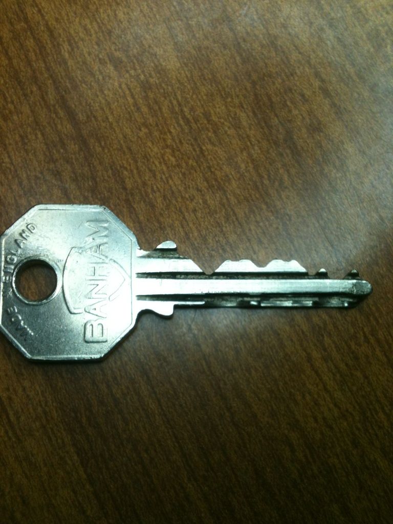

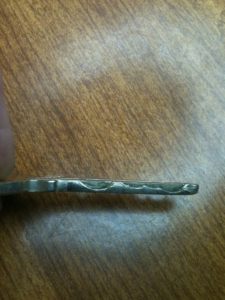

Because after taking it apart years ago for a post on the high security Banham (Equivalent of the Yale 5000), while reassembling I accidentally turned the plug back right before the plug was fully inserted. The plug was forward a bit so I could insert the cam in the center of the profile lock. The driver pins/springs dropped down into the pin channels, but off by one channel. So I could not remove the plug, and could not insert the key for easy disassembly. I drilled the pin channel caps/plugs to disassemble the lock without damage. The Banham is now reassembled and working well.
Here is the key to the lock.
