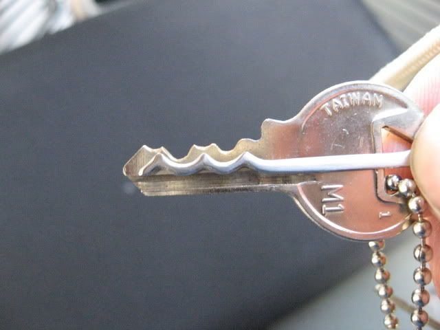

As for cutting with a file, I always find hand processes to be more accurate and meticulous than power tool processes. Here's the first key I impressioned. Sorry for the pick in the picture.
Do you see why the stainless blank took forever! I file almost all my keys after a machine cuts them anyway. The human element is highly variable, and this is what makes it superiour and more acurate, but much slower. A lock is a mechanism which requires slack to function without failure for decades. I have opened 30 year old laminated steel master locks that have been pryed on several times with severly twisted shackles, and turned face up in the rain, or face down in the mud. They always open. It speaks for the longevity of the lock. Some people criticise the way the cylinder rattles in the lock, but I have opened several mudpie, over charcoaled, rusted closed locks that should have been lockouts, and did so without using any solvents. I think it's why they remain a standard in an industry where they are all but obsolete.
