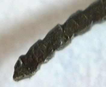

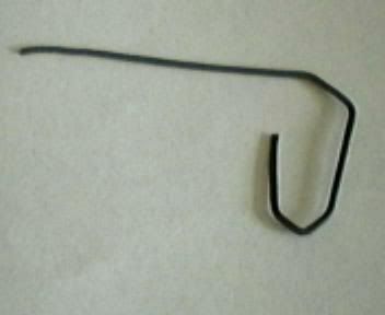

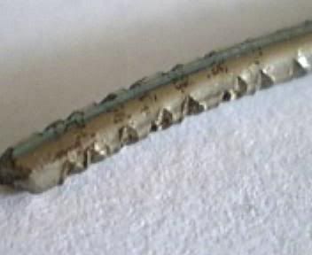

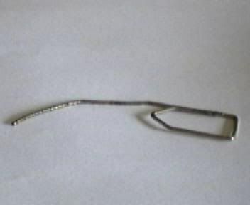

Postby Wrenchman » 6 Apr 2006 13:21
You can also use paperclips, like shown in the pic, they work!
Well the first one anyway,
The other one is a little bit thicker, it might work on car keys :arrow: (advanced)
Here´s how:
Take a paperclip and unfold it, now take a wire cutter, and lightly bite the paperclip like seen on the pic, and your done! Almost, cuz you will probably have to hit it a few times on the sides, to make thin enough, but now your done, happy extracting :wink:
