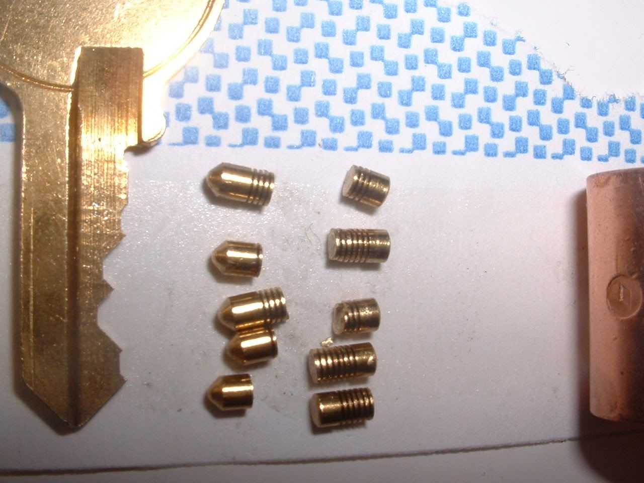

It is possible to re-shear the pins with a wrench and a decently hardened piece of metal. Honestly though, its not markedly easier than just breaking the cylinder on a normal master #3. I just tried this to see if it made a difference ...I code cut a a shallow key 2121 and tried forcing that one to turn. It seemed to need slightly less force than any of the others I just ruined...With a sample group of one (and no torque wrench) it may just have been my imagination though. These are some photos of a disassembled Master 3UP.
It's not readily apparent in any of these photos but the fifth pin position on the plug is only a small cross section of the plug with the pin driven in to provide the last driver pin when it is sheared off.
I have never noticed that these locks work any rougher than a normal master lock but I have noticed that the key is harder to insert and remove on most of them due to the plug sliding in the cylinder. I don't think it is possible to pull the plug out and re-cut it to a different key either. My tool punches the ring on the bottom of the padlock down slightly around the face of the cylinder.
