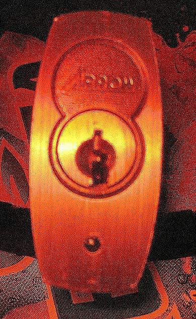

I have a cut best pad with an arrow sfic
this thing is satan's arsehole
I post when i get time but needless to say it's the warding that is getting me
the warding pratically meets the pins I have no room to pick above the ward and coming from below i have to pick through holes in the ward.....my pick gets stuck and I can can only get to the thrid pin this before &*%*^..... ideas?

Postby UWSDWF » 14 Aug 2006 7:53
LockNewbie21 wrote:Ahh i forget the keyway, but i know what your talking about, paracentric is an understatement.
Care to post a pick? No tthat i dont belive you, but i seen the key for this lock but never the warding.. i can only imgaine, actuallt said that when i seen the warding on the key
yeah I'll post a pic soon (trying to make this %&*)$%#@ camera do what I want.......
Postby UWSDWF » 14 Aug 2006 8:06
Here you go
Postby LockNewbie21 » 14 Aug 2006 9:53
OHhh thats what they look like.. christt worst than i thought jsut looking at the key, best of luck man.
I'd sat Oct. is right go for some slenders, is it 6 or 7 pin?
Well i see you will be busy for a while eh mate? :)

Postby unbreakable » 15 Aug 2006 19:08
UWSDWF wrote:Here you go
Man, thats one coool picture 8) 8)
What am I smoking?
Nasty keyway, umm, I think Euro picks would be your best bet.
