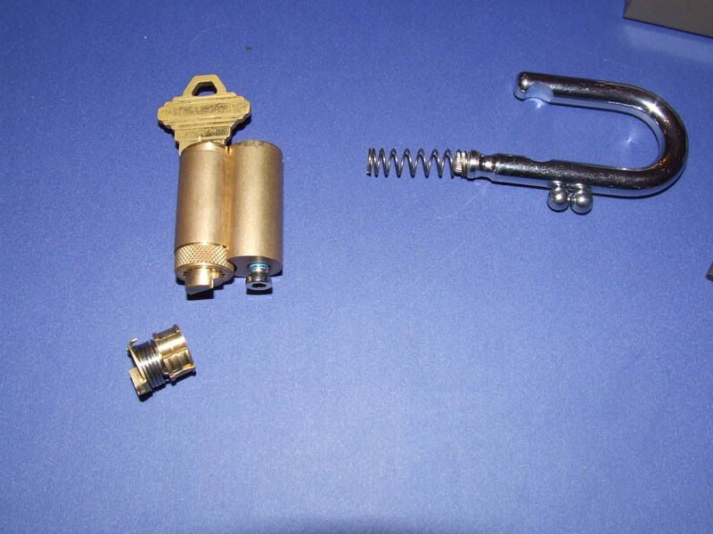

Everything all together.

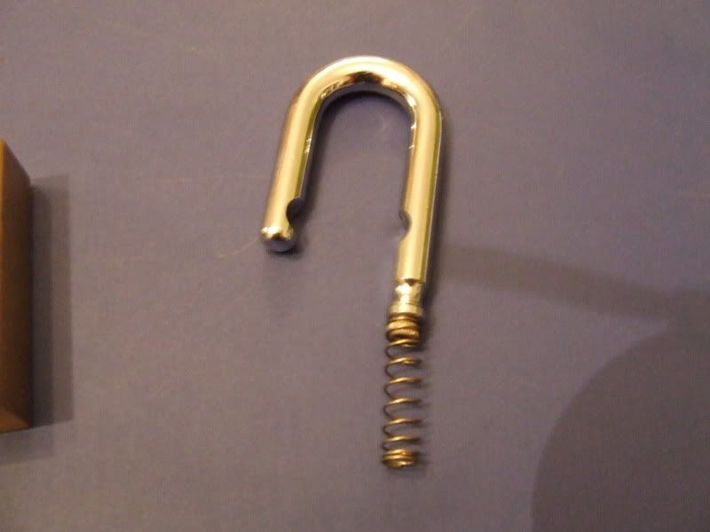

The Shackle, showing how the spring is attached to it.

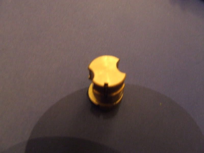

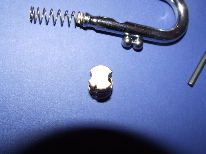

The shackle and piece that interacts with the cylinder and the balls.
Now, for the how to.
Postion the lock bottom up, with the S in brinks facing towards you,
Now, in the ball bearing hole on the side with the S, drop in the ball bearings. One will fall thru the hole, one will not. The one that doesn't fall thru is the correct one.
Now, push the shackle in, and hold it with a big elastic. Make sure its full pressed in.
now, keeping ball #1 in the hole it was earlier, drop in ball #2, into its hole. Push it in, using a pair of tweezers.

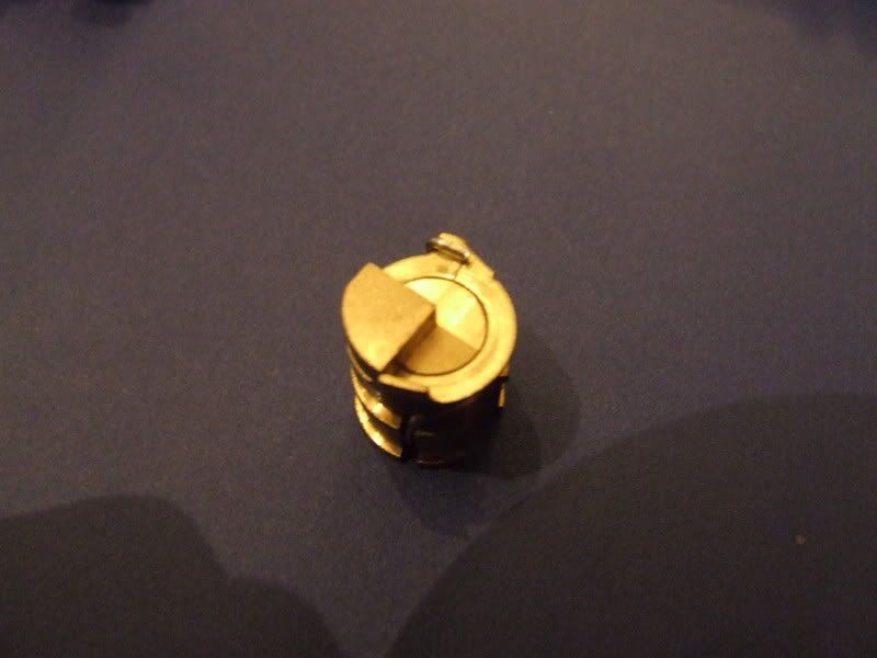

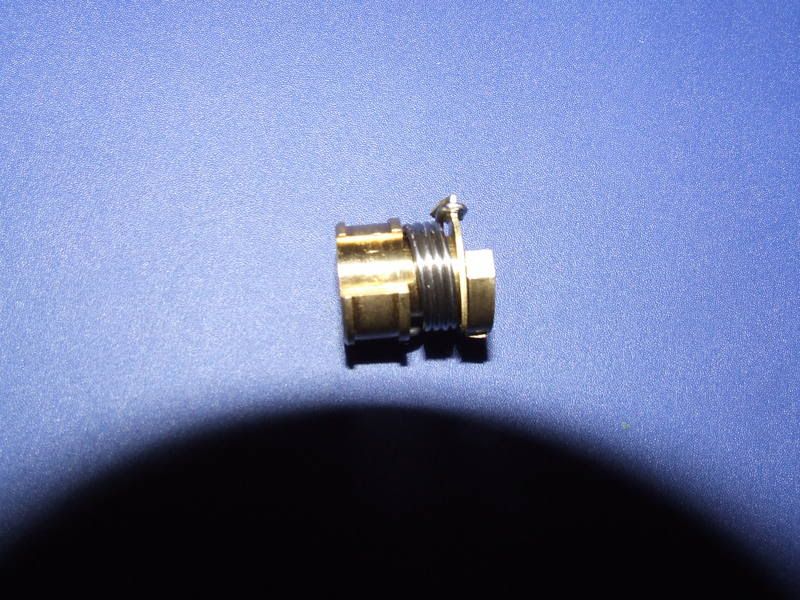

Now, inset the Round metal piece that interacts with the Cylinder + balls.
The tab that has the spring attached to it will point in the direction of the S in brinks,
It will fit into the little notch. Look inside, you'll see what I mean.
Now, push the core in, turn it a bit with the key, it should drop in fully.
Now, remove the elastic, and unlock the lock.
Make sure the core doesn't fall out, and replace the screw.
Voila.

1. The ball bearings are the same size, the will both fit through one hole, but not the other. From the way I read your description, it sounded like one ball bearing would fit through the "S" hole but not the other ball bearing. And I didn't push the shackle the entirely down: I only pushed it far enough so the indents in the shackle would line up with the holes the ball bearings go through, so that the ball bearings would sink into the shackle. If you pushed the shackle all the way in, the ball bearings would stick out into the center hole of the lock and you couldn't get the piece in your last three pics to fit in. I had to balance each ball bearing in their hole and drop the center piece in. After that, just put the pin tumbler in and turn it with the key until it sinks the whole way in like you described.
I then took it apart again and reassembled it to make sure I had everything down. The only way I can find to get that center piece out again once you dropped it in is to take the core out and then push the shackle down to lock the lock.
