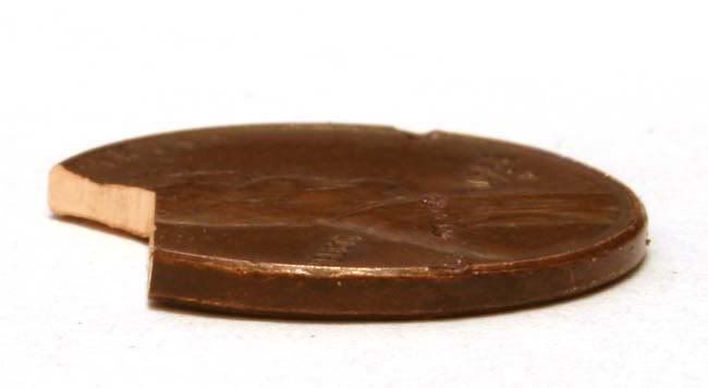

I have the 040 and do not have the problem. I can cut a key and post a pic if you like.
Postby zeke79 » 17 Jan 2007 21:08
It is really hard to see with just your eye, but zoomed in like I am here it is apparent that there is some there which I expected simply becuase of the design of the machine.

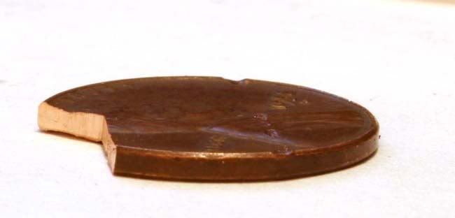

You can however make that look more severe than it is by simply changing the angle of your camera. This is the same penny shot from more of an angle.

zeke79, the angling is bad enough that I have to go back with a file and even it out to get them Best keys to even work smoothly.

I done the pic so you could see the degree of angle I get. All machines designed this way will angle to a point. You need a straight in feed machine to eliminate this such as a framon, ITL, etc. Or use a punch machine to solve the problem. All duplicators that I am aware of will copy with a slight angle.
