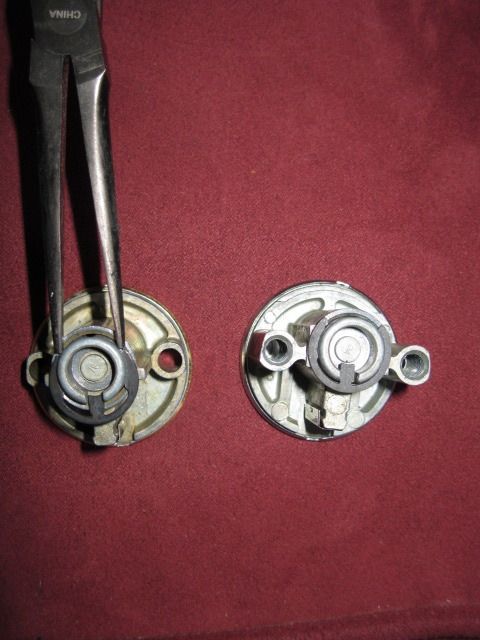

so, after taking a picture of how i do it i realized that you had already posted the fact that you have already removed the clip :evil: . Ill still post the pics so that anyone who reads this can see one method of removal. The clip on the right is basically removed, the one on the right is still fully clipped. All i do is align the tips of my tool as shown and press (in the picture i would be pressing 'down') and spread at the same time. I have bled doing this, so be careful!
Im glad you have it all sorted out and i wouldnt worry about the clip being distorted, when you put it back on it will hold it just fine.

And thanks Attic :P But yeah, if you look at my images above, the clip is pretty large and non-flexible, and it has a tiny gap, so was pretty hard to open the pliers enough to force the clip around the plug. Screwdrivers did the trick :D I'm guessing I might do a picture based guide on how to disassemble the Ruko lock, for easy overview, if someone else needs it, so they don't have to look through this whole thread? But dunno.
