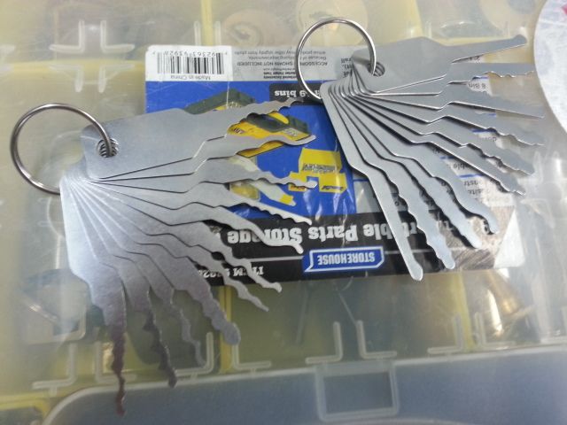

Postby FreyGrimrod » 26 Mar 2013 13:38
Here they are to the left of a set of Jigglers others may be more familiar with. The majority have a noticeable size differential. I still have yet to get them to do much of anything but need to give it some more time/haven't tried any mounted locks.
