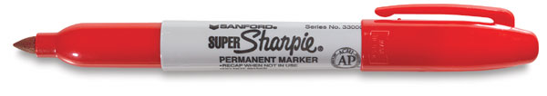

Here is a pick of my plug follower. Let me know if you would like an explenation of the special features.

I love the professionaly crafted pocket clip on the end and the secret unauthorised use, detecter (catch them red handed :lol: ),
Lol, i thought my two cupped hands would be sufficient (they were to a point)
So cupped hands then dismantled the lock,
You could always use a finger on your third hand :wink:
