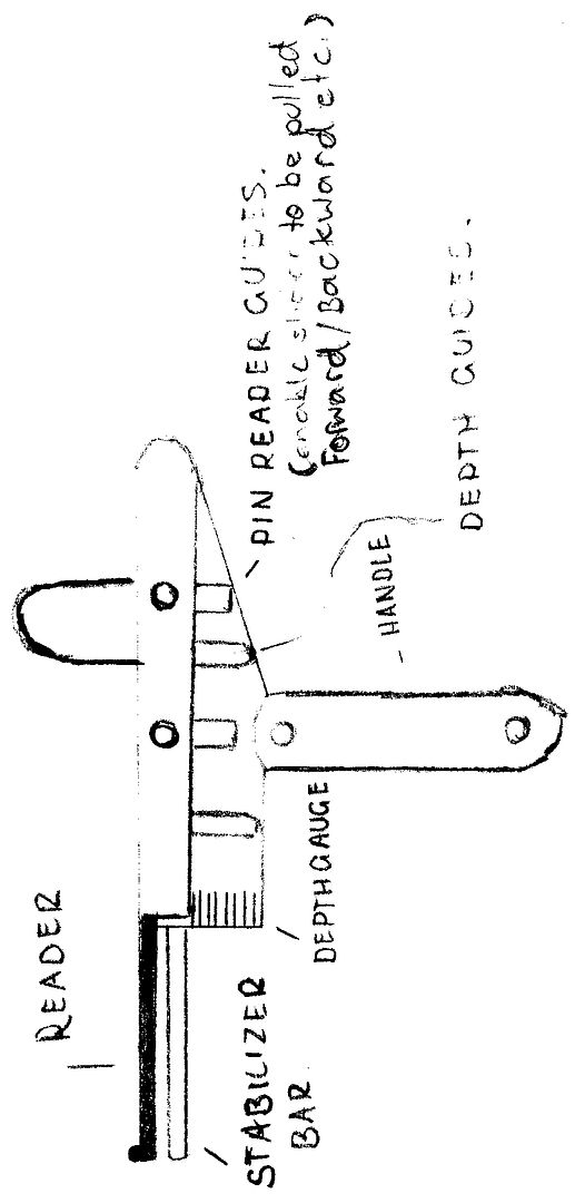

Postby skold » 22 Feb 2005 3:40
http://img.photobucket.com/albums/v329/skold/img003.bmp
Sorry it’s the wrong way up, haven’t got my scanner working to its full potential as of yet.
My basic Idea is the have a tension/stabilizer bar and have the reader have the ability to go the every pin height and lock depth in a Lockwood lock., the depths can be used as a picking guide, but it generally just used to determine the pin depth when the cylinder is turned/picked.
I am currently working in a better looking pic/drawing in Qikdraw, but the drawing seen above is just so we all have a general Idea what I am talking about.
I would like some help to refine my ideas, so that I can make this little project of mine work.
Any comments, suggestions, flames. Anything at all?
Cheers,
Skold

Postby Exodus5000 » 22 Feb 2005 8:44
Perfect Skold, that's exactly the kind of idea I was thinking, plus your version looks much better, and I like the idea of having a pin depth gauge right on the slide rather than just a ruler. Perhaps a modified steel ruler with the various pin sizes etched into it would make for easy reading. Now building and/or modifying this device should prove interesting.

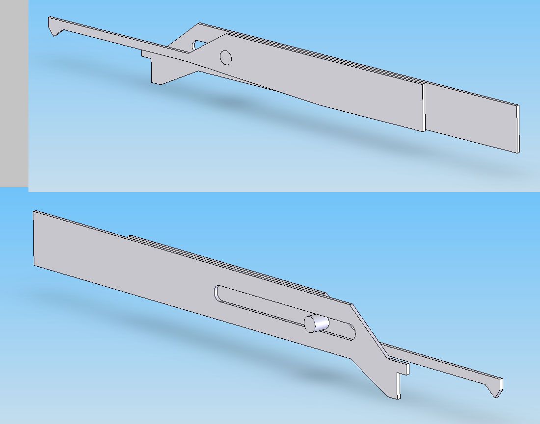

Postby macaba » 22 Feb 2005 17:28
Heres my attempt at interpreting the design
To maintain tension, you simply wrap an elastic band around it, and to have a system of measurement, there would be some kind of markings. The rest is obvious.

Postby Peaky » 23 Feb 2005 7:05
:lol: Thanks everyone, sometimes its the quick 1 min idea off the top of your head thats the best,
I will have a dabble with some wiper blades later and see if i can knock one up, at least we will have an idea of development then,
Like your idea Macaba, have a go at making yours and then we can compare and find the limitations and strengths of both then come up with an ultimate one.

macabas drawing
Postby raimundo » 23 Feb 2005 10:36
very clean and simple drawing macaba, but can I suggest that it can be more stable to hold it straight if the part of the chassis that goes into the key way be designed to go into the part of the keyway where the uncut edge of the key goes, the longer length of the part that can go in there will make holding it straight much more positive. Yes, I understand that you are doing this with the part that addresses the face of the plug, as well as the part that goes in. I'm just suggesting a modification.

Re: macabas drawing
Postby macaba » 23 Feb 2005 12:31
raimundo wrote:very clean and simple drawing macaba, but can I suggest that it can be more stable to hold it straight if the part of the chassis that goes into the key way be designed to go into the part of the keyway where the uncut edge of the key goes, the longer length of the part that can go in there will make holding it straight much more positive. Yes, I understand that you are doing this with the part that addresses the face of the plug, as well as the part that goes in. I'm just suggesting a modification.
The exact reason why i didn't do this is because the keyway of this cheap euro lock i have here is very rescrictive. In order to get something at the top of the keyway, i would have to incorporate a bend into the design, which would also mean that it may not work on certain keyways and different size locks. the advantage with the way i have drawn, is that it always measures from the very bottom of the keyway, and an uncut key is at the bottom of the keyway, so it makes it so that on any size lock, its universal, as its measuring from a point that is universal on any uncut key. :D

Postby macaba » 23 Feb 2005 12:35
toomush2drink wrote:I love this idea but see one problem at the moment this will only work on locks with not much in the way of warding. I suppose it depends on which part of the keyway the bottom of the tool is inserted.
Great idea though :D
I am assuming that most pin tumblers have an length between the face of the lock, and the first pin, which is where the sticking out bit goes in. I also put the pick part on the left surface, as thats the bestest arrangment for the wards on this euro lock i have here, as i've attempted to depict below.
