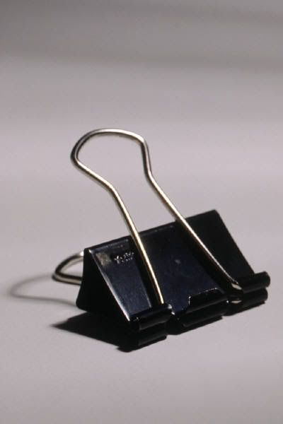

And if you take the handle off an appropriately sized bulldog clip, it pretty well works like a key, so picking is not a problem - double lock or not. 8)

yea i was just reading about that bull dog clip idea

Postby HeadHunterCEO » 20 Dec 2005 7:13

Postby Chrispy » 20 Dec 2005 7:26
How to use 'em.
Picture: http://www.dorothymcghie.com/services.html

Yes he does use a Southord Hook in the Video. Any piece of metal bent like a key can be used to pick handcuffs (hence Chrispy's Bulldog Clip idea) :wink:
