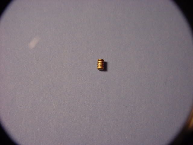

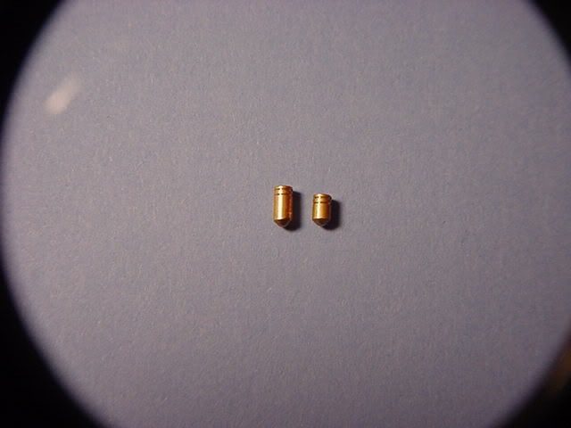

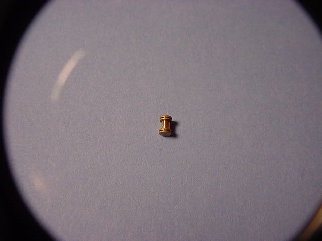

Here are a few I have taken pics of:
Serrated Spool:
Partial Serrated:
Full Serrated:
There are more and can be defeated with practice and skill. Hope this helps. :)
