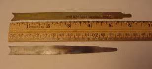

Postby ComTech » 28 Oct 2006 20:53
Here's a photo of a kiwkset cylinder removal tool. The Kiwkset one is above the ruler, the one below the ruler is made from a saw blade.
It works on the standard cheap 5 pin locks.
Hope this help a little.

Postby concisexj » 1 Nov 2006 10:55
Thank you guys but I created a tool from a saw blade just like the one described and it worked great. Just wish I had seen the photos first ;)
