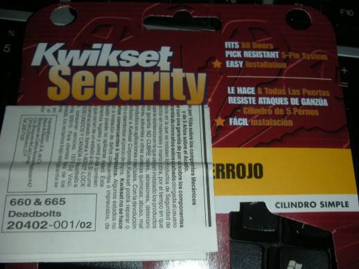

So I decided to go by a lock at lowes. Went there and had a 20 on me so I picked a Kwikset deadbolt for $14 after seeing on the package that it said it was pick resistant.
[img]http://i72.photobucket.com/albums/i180/brmse/kwik.jpg
So I thought I would get my money worth and learn something. I took it apart and didnt notice the pins where a set of bottoms that touch the key(these pins have beveled edges.) and a set of tops(no bevels). so I was putting it together wrong at first and it would acted funny so I took the pins out again and figured it out right.
So I put three sets of pins in there and had it picked with the lazy curve type hook pick within about 3 minutes.
I did this over and over again holding the pick different ways and looking and not looking, trying to get a mental picture of the inside of the keyway. Next day I tried to pick it with all the pins but when starting from back to front (thought I read somewhere going this direction was proper) the last pin would pop back out by thr time I got to the front. So I started going from front pins to back pins and I now I can pick this lock in under 30 seconds with all 5 pins. I feel like I shoulda bought a grinder and some hacksaw blades instead of a pick set. theres a good video on youtube of how to make tension wrenches and picks, I only liked so far the lazier hook, but im pretty happy with my South0rd but I shoulda got the cheapest slimline set they have. All in all this has been really fun and I immediately learned how to rekey locks and rekeyed mine according to key, so I did really learn alot withing 48 hours.
I do have a question tho, is there a web site I can find pins and springs and the other loose pieces for rekeyables, are they mostly vendor specific or for say the same type of deadbolts are they all pretty much the same?[/img]
