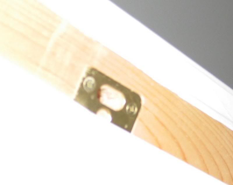

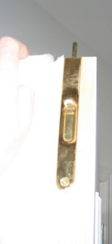

The door that's usually immobile has a top and bottom pin that might be 1 - 1.5" long that enter the door jamb at the top and bottom (I think that it's the name). There's only a little metal plate holding it there:
Top pin:
Top door jamb (less than 1" deep)

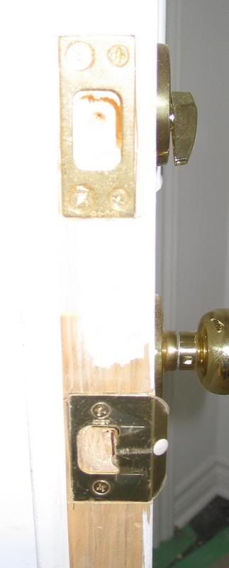

The immobile door, could I put a stike box in there or it would be useless?

But even if I put a solid core door, wouldn't the weakest link be the top and bottom pins that will go right through the jamb? I suppose that I could use 3" screws so that they are in the door frame, that would help..

1. Cover those flush bolts with plates so that the plates would have to be removed to open that door. The reason for this is; when the doors are locked, if you push against the normal working door you create a gap exposing the flush bolts. The flush bolts can be slid up and down and both doors will open!
2. Get a strike plate that mounts the full length of the frame (or the second door in your case). It's held on with approx. 20 screws. This will distribute the force from a kick in attempt over the full length, which will be stronger than just a small strike with 2 screws. PLS products make these as well as others.
3.Install those flip over locks (Snib locks) at the top of both doors. These are those rectangular things that are screwed into the frames (use 3 inch screws) and flip over to block the door. When used someone with a key will not be able to come in. Use in a locked possition all the time on the second door, and only at night on the main door. This will add strength again, because those flush bolts are pretty flimsy.
4. Install longer screws into the top strike of the flush bolt.

Also if you have double doors something like a Lockwood 355 is perfect, you can fit it in under 20 minutes and it bolts both doors together, so if your flushbolts break on the fixed door, they still wont get in, but also make sure you have some good fixed pin hinges
