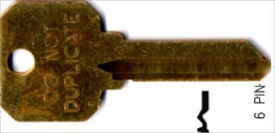

I just bought some steel 35-056L blanks a couple of weeks ago. They're the IC control key version of the 35-100L (picture on the bottom left). They seem to be getting harder to find, maybe because now that Schlage has the Everest keyways, they're not doing too much with their old numbered and lettered keyways anymore. If you’re concerned about steel blanks, Ilco makes a brass version of this key. Brass may be a bit flimsy on a key blank this thin, but if you’re interested their item number for this key is 1145L (picture on the bottom right).
I was worried about messing up one of my cutting wheels on these so when I bought them I asked if I needed a carbide cutter. A guy at my supplier said he has cut a lot of them and as long as you go really slow he said he’s never had a problem when using a regular cutting wheel, but I haven’t tried it yet so I can’t personally vouch for this. If you find a method that works for you without damaging your equipment please post it back here.
Image Image

the diagramed blank has the seventh pin cut for key control, (changing out ic cores) but the brass dnd bow blank is just six pin.
Postby MBI » 17 Nov 2007 11:52
I picked up the 35-056L blanks at a wholesale locksmith supply place. They were old stock and I bought the last six they had. They don't even stock the Schlage 35-100L blanks anymore. The guy I usually deal with over there said he couldn't even remember the last time anyone asked for them. I had to buy the Ilco 1145L keys in order to be able to cut any change keys.
You're right raimundo, in rereading my earlier post I realize I should have been more specific because it does sound kind of like I said the Ilco key is a brass version of the steel control key blank. To clarify: in the pictures of key blanks I posted above, the one on the left is a steel 35-056L control key blank and the one on the right is a brass Ilco DND Neuter Bow version of the Schlage 35-100L key blanks that WOT purchased.
WOT, PM me and let me know specifically what you need, with quantities. If it’s the 35-056L blanks, they’re out of them and it didn’t sound like they planned to resupply, but I can have them check availability from Schlage on a special order. On the 35-100L blanks, the Ilco number is 1145L but they make both a 5 pin and 6 pin version so verify what you order. I just looked it up again and noticed that Jet also makes a nickel-silver version of the 35-100L, their item number is 101-L-NS.
