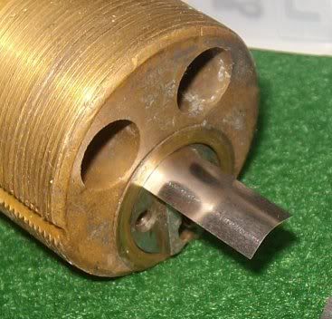

Here's a couple of pictures of a lock being shimmed for anyone who can't quite picture it.
As the shim is slid in, the pins have to be raised to the shear line. An uncut key is a good way to do this, as you slowly slid the key out and let each pin lower, the shim just sort of slips along until it's all the way in. Easier and faster than picking in most cases if you have a lock to disassemble to rekey.
It's not a way to open a lock. The plug has a wide ridge on the face side of the lock so a shim can only be inserted from the back after the cylinder and the plug retainer is removed
