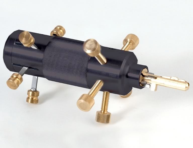

Hello
A sample of an Umbrella (parapluie).

Postby quintaux » 9 Feb 2009 8:03
Umbrella for CAVITH ?

Postby Fredmad » 11 Feb 2009 2:33
quintaux wrote:Umbrella for CAVITH ?
Yes

To the original poster - there is at least one UK tool for Bramah, but it cannot be discussed in the open forums. The basic idea is pretty simple, and if you understand how the modern Bramah lock works, you will get some ideas about how to open them via NDE.
Fredmad - I guessed that parapluie was for Cavith - you can tell from the 3 axial pin pushers on the end of the tool.

Postby Fredmad » 17 Feb 2009 12:48
I know that how to use this kind of tools is advanced forum. I don't want to explain how to use but just want to answer Greyman.
The 3 pieces on the end of the tool are variable pieces so that when you get the code you put them to turn. In fact Cavith as 5 pump and 3 pins.
Very quickly explained...

Postby FrenchKey » 22 Feb 2009 13:15
Those kind of tools are similar to tubular pick, but they often are used in a picking/decoding way, while tubular picks uses self-impressioning techniques.
With this kind of tools, you have to tension the lock and push each pump ( = Pompe in french = Bramah lock active component) in order to feel the gates. The tricky matter is to differentiate true and false gates, but with some experience and a good knowledge of the lock, it's possible. For each brand, the behaviour of true and false gates are quite different.
For that specific lock, you have to deal with some pins too, but fredmad did not say exactly how to decode the 3 axial pins in order to choose the right variables pieces with his specific tool. But those 3 pins do not have so much protection as serrated or so and can be picked easily.
This kind of locks can also be picked with One wrench and One straight feeler. I never tried myself on a Cavith one specifically, but I successfully picked some others French Pumps locks in that way.
The main drawback of this method is the time. You need to pick several time to do One whole rotation, while an umbrella will keep the code.
But once you have picked it, you can decode easily (because of the construction of the lock) the code and produce a working key.
I hope it will help som of you

Postby Fredmad » 27 Feb 2009 5:21
That wrong. Old generation didn't have no security driver but since 4 years Cavith has serrated dirvers.
