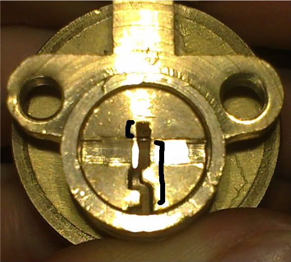

I was making a practice lock with three pins and aswhile I was removing the key *doh* slipped and the chamber
straightend inline and came out a notch.. leaving me with the key stuck, can't push/pull it out or twist it get a pick in and don't see a shim
being any help... :?
Any ideas or would scrapping it be the best option?
Cheers.
(have a photo but won't let me upload it.)

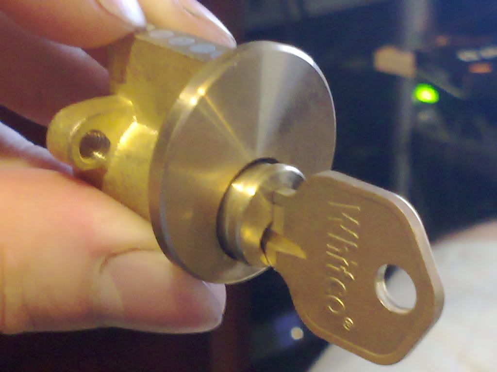

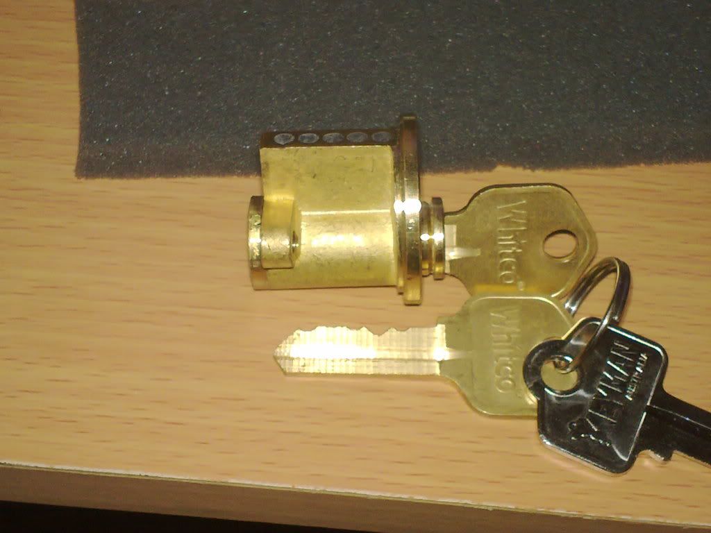

Postby tfjh » 17 May 2011 4:06
Just a couple more photo's if it helps..
back of the lock
the lock is fairly loose, bit of give in all directions about a mm..
