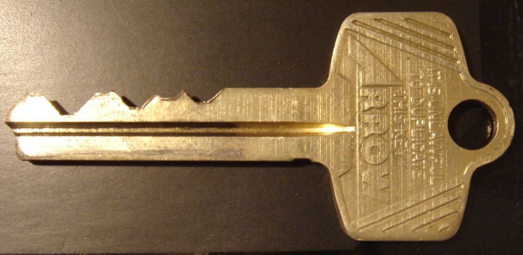

Another Question guys the lock is very jammed up even with the key but it still operates i was wondering why the key looks kinda sloppy on the cuts bunch of weird questions but yeah and i can't get the control i only have a home made hook im looking in to getting some pick but there costly ): I Have alot of photos but it says they are to large to post

wasper43 wrote:Another Question guys the lock is very jammed up even with the key but it still operates i was wondering why the key looks kinda sloppy on the cuts bunch of weird questions but yeah and i can't get the control i only have a home made hook im looking in to getting some pick but there costly ): I Have alot of photos but it says they are to large to post
upload pics to tinypic.com and then paste the http:// links here.
If this lock is gummed up and dirty, spray something in there first, that may be what is stopping you from picking it. I don't usually recommend it, but since it is a common item, if you have some WD40, spray it in there, or any Silicone spray you have.

Postby wasper43 » 5 Dec 2011 0:56
Reason: I fixed the URLs for ya. all you need is [URL]http://domain.com/file.jpg[/URL]

Postby Squelchtone » 5 Dec 2011 7:20
Ouch, the person who made that key should be slapped. I always debur my keys, it makes them operate much easier when you remove all that excess metal =) If you have a bench grinder with a wire wheel, you can clean that key up very easily.
Keep trying to pick that lock, you're almost there!
