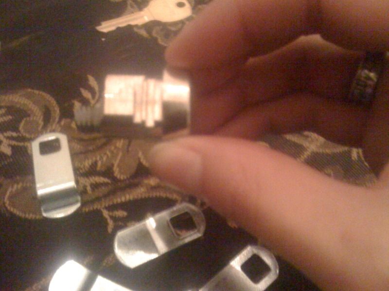

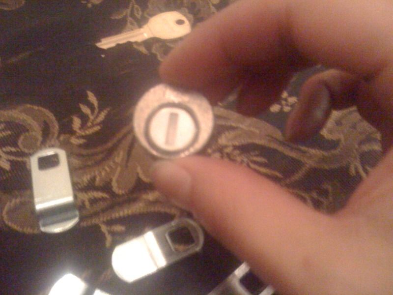

Yeah, I know how it looks so I'm posting pics of my lock.
I've been reading through these forums for almost six months now.
I say "Everyone" as in other web sources and a couple of locksmiths I spoke to personally. All I hear is that these things are difficult and I actually am having a bit of trouble (moreso than usual anyway).
Thanks for the advice though.
C8735 "Clockwise Dust Shutter"

I'm not sold.. how do we know that's your couch, we're gonna need receipts :-P
Based on the key, insert a half diamond all the way, apply medium tension, and then pull the half diamond out quickly as you at the same time lift it against the pins to push them up. Don't let go of the tension, and insert half diamond in again all the way and repeat this 5 or 6 times. It should open. Make sure you're tensioning in the correct direction in case the cam is made only to turn +90 degrees, or -90 degrees.
Good luck!

Sweet! It worked. Not a couch, it's a table cloth and the receipt is long gone, but this might work lol.
