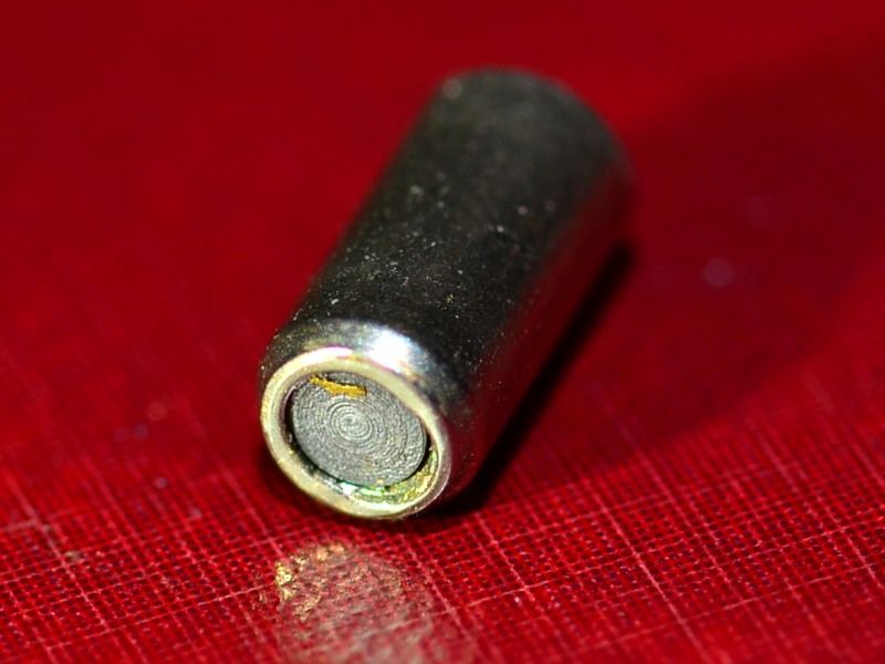

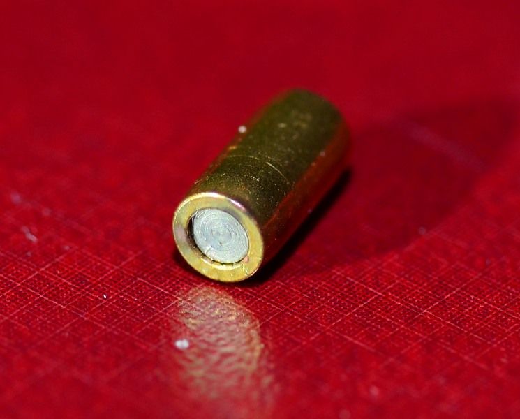

Took apart one Assa cylinder (thanks Femurat for the idea, works great!) and found something odd inside.

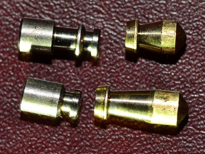

Nice security pins of course,
but these two brass driver pins with steel inlays are weird. Why are they produced that way? Steel insert isn´t magnetic but of course grips with one.
And same design is also with two key pins made of steel:

Those are hardened steel inserts to make the lock more pick resistant.
Re: What is this inlay pin?
Postby GWiens2001 » 12 Oct 2012 9:06
Oops, I mean DRILL resistant. For the ROTARY pick. :oops:

Very nice security pins. Yes steel pins are for drill resistance. Dunno about the steel insert, maybe the brass around it avoid wear in the chamber...

Driver pins are not but key pins are very slightly magnetic. Not enough to lift anything.

The reason they don't make the entire pin out of the hardened material is to save money. They can just ram a bit of drill rod down each and job done, versus machining and then hardening something.

Yup, that's it exactly. Also what femurat said is correct as well, if you have two dissimilar metals making contact with each other in motion the harder one will win out and abrade the softer metal.
