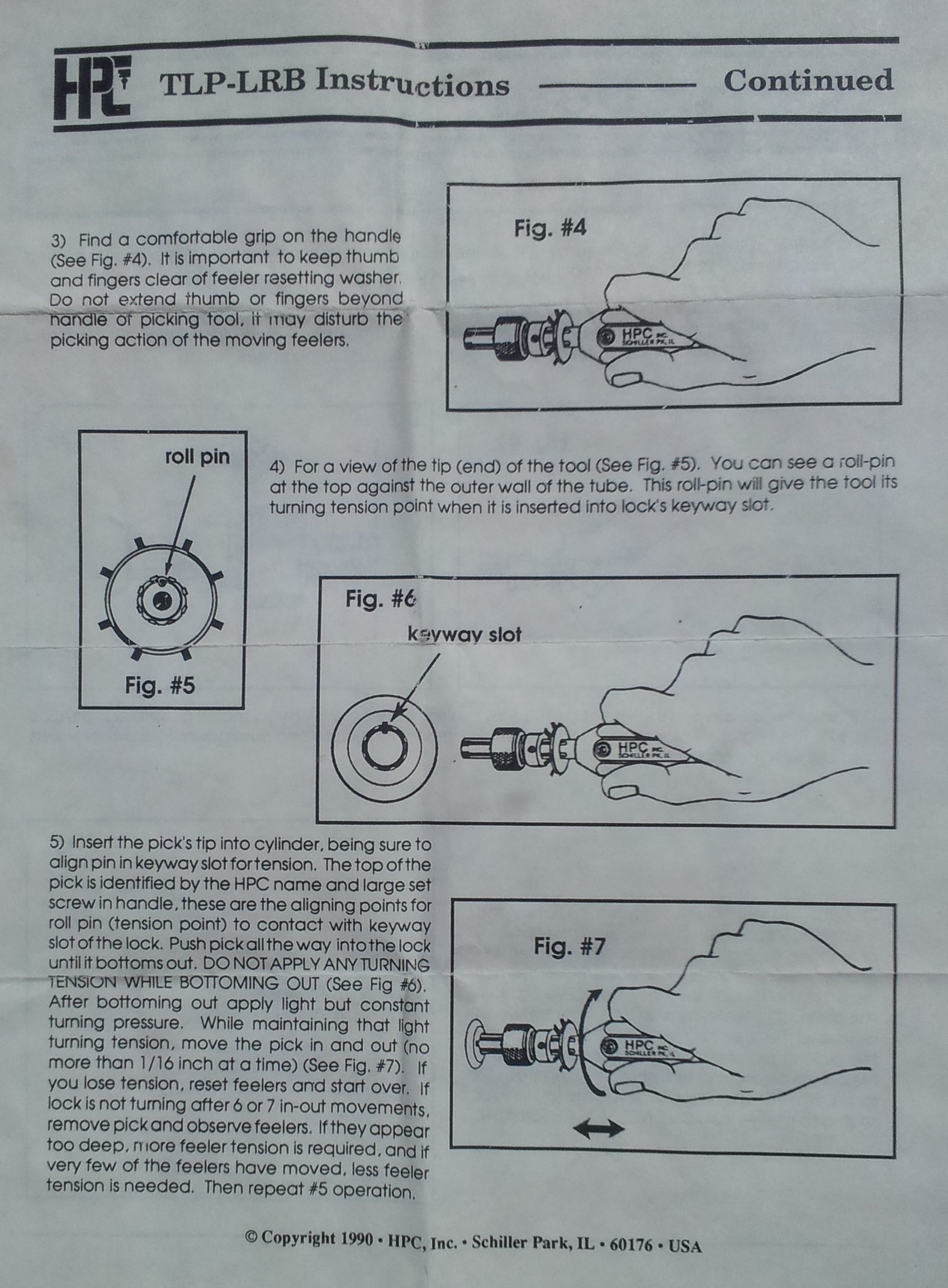

EDIT: here the instruction page of my TLP-LRB:
http://7fw.de/tmp/tlp-lrb_instructions-1.jpg
http://7fw.de/tmp/tlp-lrb_instructions-2.jpg

That photo shows the newer kind of 7 pin center without the cut in the center for the roll pin in the center of the pick to fit into.
The key probably does not have the "nub" on the inside, just the outside.
If this is the case, the roll pin would have to be removed from the pick tool , otherwise the tool will not seat into the lock .
Someone correct me if I am wrong.

Postby franc » 19 Jun 2013 10:31
smokingman wrote:... the roll pin would have to be removed from the pick tool , otherwise the tool will not seat into the lock ...
Yes, the roll pin blocks the tube to enter the lock. But the tubular pick has no "nub" outside to turn the lock, so if I removed the roll pin, I still couldn't use the pick tool because I wouldn't be able to turn the lock, after successfully picked, I think.
Please correct me, if I am wrong.

Postby smokingman » 19 Jun 2013 10:40
As the newer locks such as the one pictured have no such piece, it is not really needed for it to operate.
I have removed the one on my tool and it still turns the lock mechanism by using the pins instead.

Postby franc » 19 Jun 2013 11:19
No, it doesn't work like that.
I removed the roll pin and the tubular pick is now able to enter the lock.
But I cannot turn the lock just with the feelers. I need this "nub" to turn, I guess.
No way to open it, even when I set and fix the feelers on the postions they should be set, copying the setting from the original key.
It doesn't turn the lock with the feelers :(

Postby smokingman » 19 Jun 2013 12:18
franc wrote:No, it doesn't work like that.
Did you actually "pick" the lock or just put the tool in?
You must genly slide the tool in and out obout 1/16 of an inch just a few
times to set the pins while gently applying torque.

Postby franc » 19 Jun 2013 12:30
Even when the pins are set (I have the key!) I cannot turn the lock. The feelers won't hold the tube.

Postby smokingman » 19 Jun 2013 12:34
franc wrote:Even when the pins are set (I have the key!) I cannot turn the lock. The feelers won't hold the tube.
Ok, put the pin back in I guess, sorry just trying to help.

Postby smokingman » 19 Jun 2013 12:49
franc wrote:
smokingman wrote:...Does the key have that piece inside the barrel of the key?
No, outside, like it is visible (marked with a red circle) on my image in the first post.
Then that tool will not work with the pin in and must not work eith it out then sorry
thought it was worth a try.
My tool works on all of them.
Well good luck and try the other tools for this type of lock.
