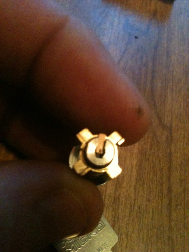

KABA Micro switch lock could be set up to be used that way easily enough.

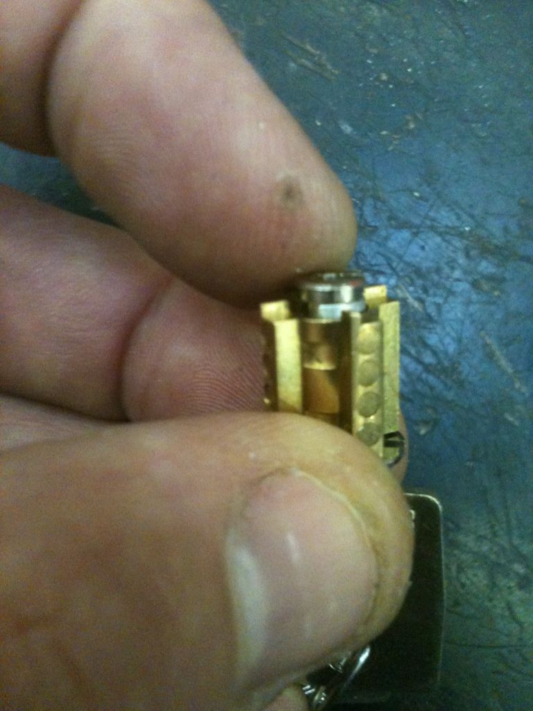

Not quite what you're talking about, but I remember my old boss teaching me to pick open the lock on top of a gumball machine. I'm pretty sure it was some kind of double-sided wafer lock...you had to pick again at every 90 degree turn, four times for each full rotation of the cylinder. Annoying as hell. :)
I think Detex panic bars have that same type of lock holding their case on...only one-sided this time, but the key lets you unscrew the cylinder, otherwise you'd have to pick over and over to get it out.

Postby GWiens2001 » 27 Dec 2013 12:57
Just don't pack it so tight that the foam expands and lifts the wafers up as you turn the plug. The wafers block at both top and bottom of the plug, so they need to be kept in place.
