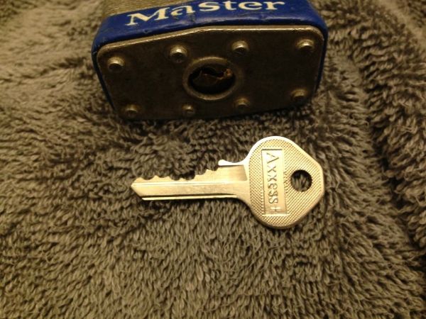

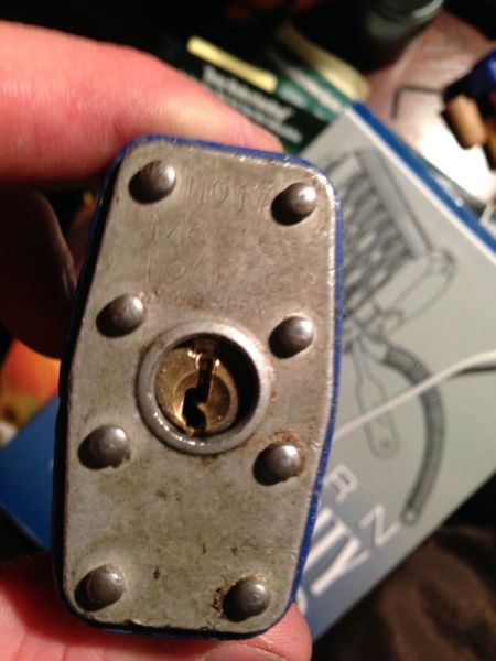

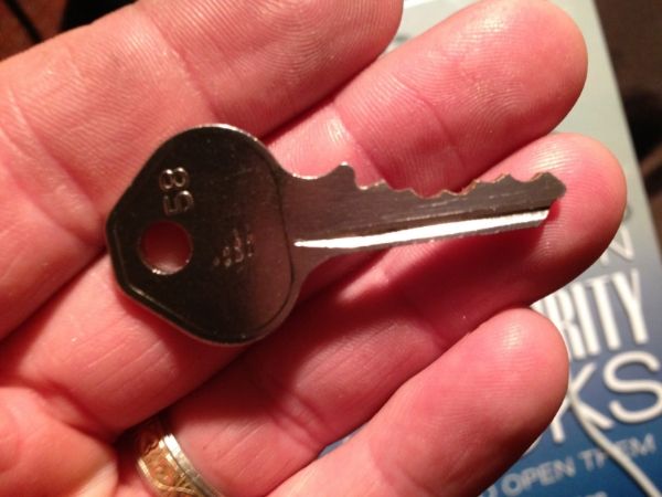

Postby phrygianradar » 20 Apr 2014 22:34
This seemed like a good place to put my post as well, so I hope nobody minds very much… Don't mean to hijack your thread Divinorum :oops:
I got this Master lock no.17 up in Big Bear a LONG time ago at an antique store for five bucks and have been trying to impression a key for it almost as long; with no success. I was spending so much time and being very careful and still no go! :? Finally I got it to impression tonight! Oh my, what a great feeling! I was going to be done for the night and was doing my last pass before giving up and scrapping the key to start over another time; like I said, I had been down this road before, like 7 or 8 times…
The last time I jiggled the key in the plug I though that I had snapped the key off in it because it gave all of a sudden! When I looked down there she was all finished! And I have to say, not to toot my own horn (toot, toot) it is like butter! So smooth… Anyway, here are a few pics of the aftermath. I would have taken shots along the way but I had no real intention of succeeding. I know that sounds kind of defeatist, but seriously after as many times as I tried with no success, it is just the reality. I guess practice make perfect; not that I'm prefect, far from it, but I got my first five pin Master lock impressioned! :mrgreen:
Thanks for checking it out!

Postby phrygianradar » 20 Apr 2014 23:48
Divinorum wrote:Congrats man! That's an awesome looking key. Since posting this thread I have tried to blindly impression a Schlage knockoff with a C keyway and am not having any luck yet. Identifying the marks is proving to be difficult. I was using the method where you give the top of the key a few passes with the file before jiggling and then after the marks are supposed to standout among the file marks.
I think the problem could be either the vice or vice grips. The suction cup vice is not very sturdy and gives when jiggling. The vice grips also have some give because they don't grip the whole bow of the key. It only grips in 1 spot at the narrowest point of the jaws. After resolving those issues if I still cant see anything I would like to try the marker method. Anyways, great work!
Thank you, and those are great ideas. I had an idea that I had never heard before, although I am sure that others may have thought of it as well. I was having a very hard time identifying marks as well and had tried a flame and markers etc., but then I got some 600 grit sand paper, cut a small strip (like really small!) and after making my filings I would wrap that sand paper around my file and gently buff the key cuts that I was working on. When they were nice and smooth again I would jiggle the key only about 10 times or so; not too much. If it made any roughing of the smoothness, I would give it another go with the file and then buff it again with the sand paper. It was a bit time consuming, but it finally worked! I am sure some of the better impressioners may have an opinion about my method, and I would love to hear any feedback about it, but I really liked doing it that way because I don't have very good files and it seemed to be a bit better than what I had been trying before. Also, I use a little loop that I got off Amazon (my wife got for me for Christmas last year, actually) to see the marks better. That combination really worked well for me. If you try it that way, be sure to use the wet sand paper at least 600 grit. I didn't make it wet and I''m not sure if that would be a good idea. For some reason I don't think it would be too smart… :lol:
Thanks again for letting me piggy-back on your thread. Like I said, this was the first time I had successfully impressioned a key and I am still on a little high from it! The coolest part is that this is the only way I would have ever been able to get a key for this lock as it can't be taken apart. I had to do it blind as well since I bought it from an antique store with no key… It has a really thick shackle and I really like it. As far as Master locks go, it is one of my all time favorites!
