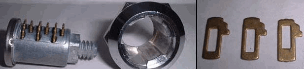

check out this animation on wafer locks, it will explain a lot.
this photos shows why you can pick it at 12,3,6, and 9

Thanks bros that's exactly what I figured...
